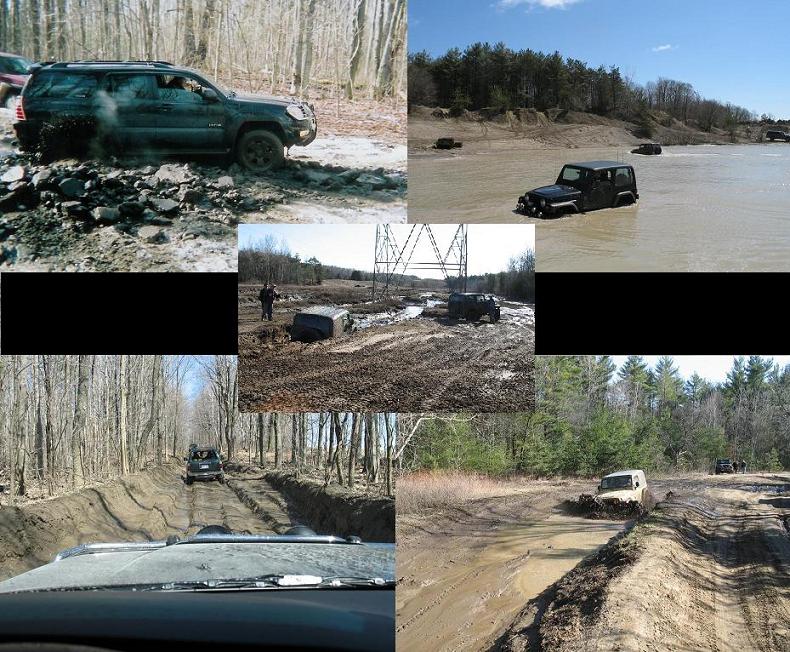

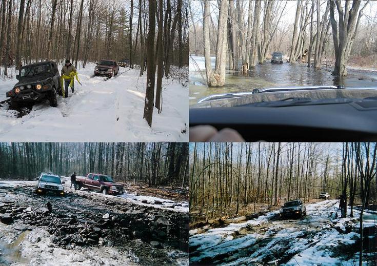

My friend has 3rd Gen. and I want to go in places where he can go.
Here are couple pictures of places I need mys suspension be prepare of
Thai said:
I am a bit confused by your signature...do you use the Goodyear MT/R's when you off-road?? For deep mud, the MT/R's do gunk up quick. I think that the BFG M/Ts clean better in deep mud.
My idea was to use MT/Rs in summer and Revos in winter.
I've talked to the people and seen personally on trails MT/Rs and T/A KO on trail on two Rubicons with similar setup. MT/Rs perform better in mix mud/snow condition.
I believe you. MT's do very well in snow for similar reasons why they do well in mud. They clean exceptionally well.
