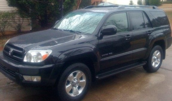

need i lift kit for my new T4R 2005 limited 4WD V6. i need something that i can go offroading in like a 3" lift or a 4" lift (revtek or cornfed or something) and slap some BFG km2's or some sort of offroad tire. pleeease help. what's best, from experience???
thanks for anything at all!!!!!!

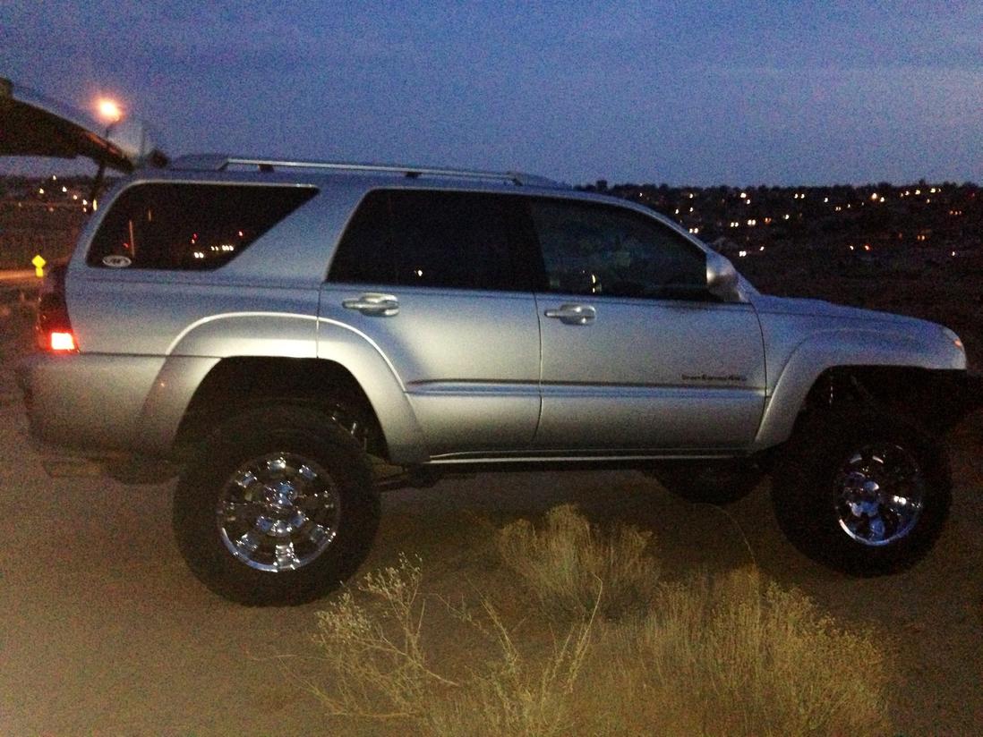

Old man emu 887 springs w/ bilstein 5160 fronts and 5165 with piggy back rear shocks. The old man emu alone with its shocks will give you 2.5-3 " but the bilstein shocks have a taller seat for the spring which means much more lift , my truck is almost 5.5" taller + rims and tires . I'm running 18 x12 " rims and 315 70 BFg's = 34" . You will need a diff drop!
