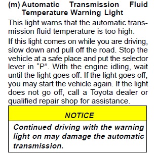

According to Toyota it says IF the trans temp light comes on, stop and let it go out. If it does, keep driving. If it doesn't call for a tow. Your light didn't even come on and probably wouldn't for another 25+ degrees. So according to Toyota you were within normal operating specs.
Notice, "continued driving with the light on "MAY" damage the trans..."

Any chance of posting a pic of the dash and circling that light? Curious to see if I have that, in my '01 SR5

You definitely have the tranny overheat light, it wasn't an option, just there.
Now whether it still works on you 01 is another matter, but I would imagine it does and you are fine. Check to see if the fluid is smelling a bit burnt, if your not fully comfortable change it.
I think that blurb from Toyota is pretty funny. It says if the light comes on stop and put it in P and idle until the light goes off. If it does you can re-start the truck and drive on. Last I knew idling was still running, so how can you then re-start the truck? Do you have to turn off and then back on once the light goes off. And please understand I don't need explanations as I am not worried at all and know what I would do, just pointing out that the warning in not clear as to the proper procedure.
I think they left out a word. I think they meant "start driving the vehicle". I agree it does sound funny the way they worded it.
Hell i did just that without knowing, just made sure the fan was running.
