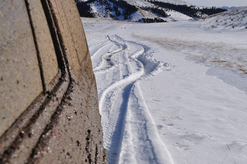

yeah, sorry didn't specify.
I took a drive and with this so called winter being so warm the roads where slop. was like driving on ice sometimes. the tires did better once i got to the snow though. they do good for the most part, but was surprised how they reacted to the soft muddy road I was driving on.
