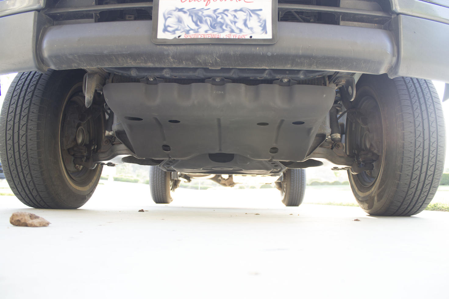

no, only the limiteds have the multi-mode tcase(the push button you speak of), the base and sr5 has a standard tcase no bells, no whistles, manual "J" shifter. you can take a trans from any 4runner without a muti-mode. id also recomend getting the drive lines from the donor vehicle as well. i dont think you will need new spindles, i think the 2wd spindles are the same as the 4wds, they are just capped because they do not have the CVs.
notice the caps in the spindles? you might have to press new bearing into the spindles but i think they are the same spindle, maybe someone else can chime in and confirm or inform other wise.

Well that makes things much simpler. Bolting up a linkage with a manual shifter and cutting a hole for it is easy stuff. I had read in another write-up that the 2wd spindles don't have splines in them for the CV shafts. If I did find a donor vehicle I would just take the spindles off of that instead of pressing in new bearings unless the bearings on the 4wd spindle are toast. In that case I would do what you mentioned.
