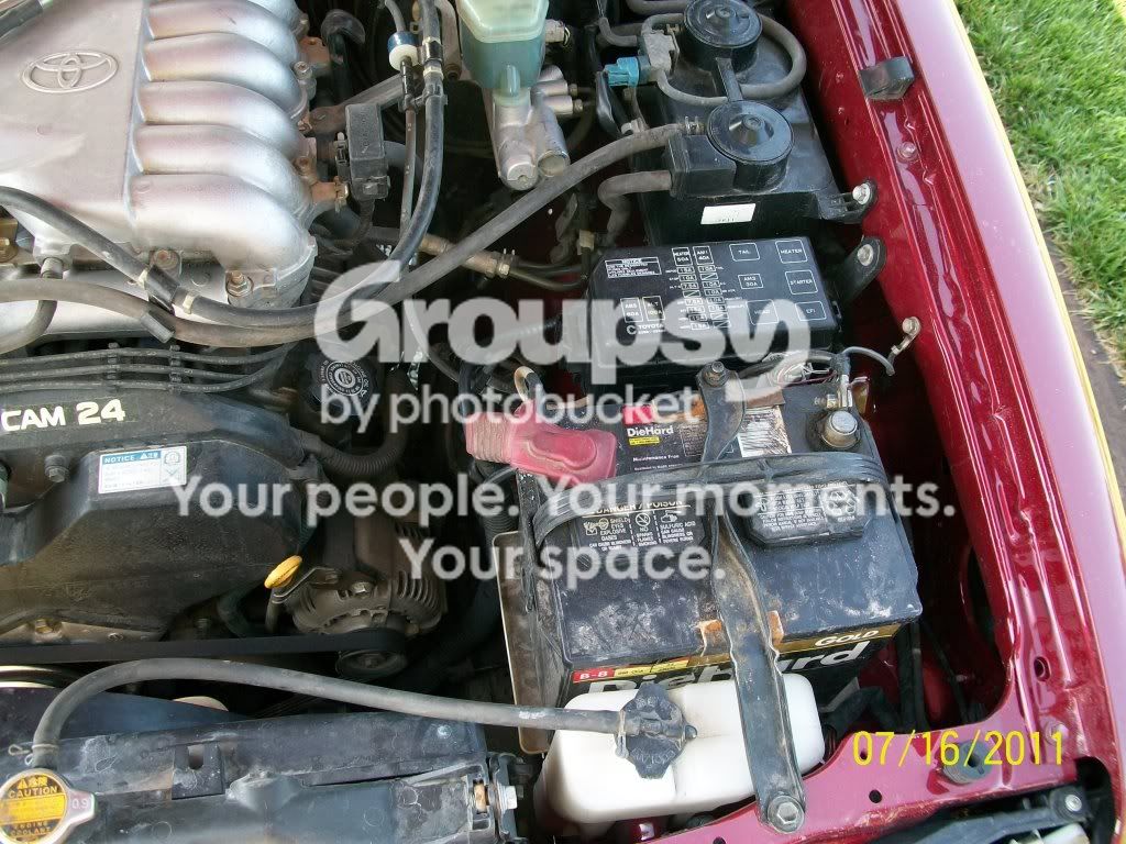

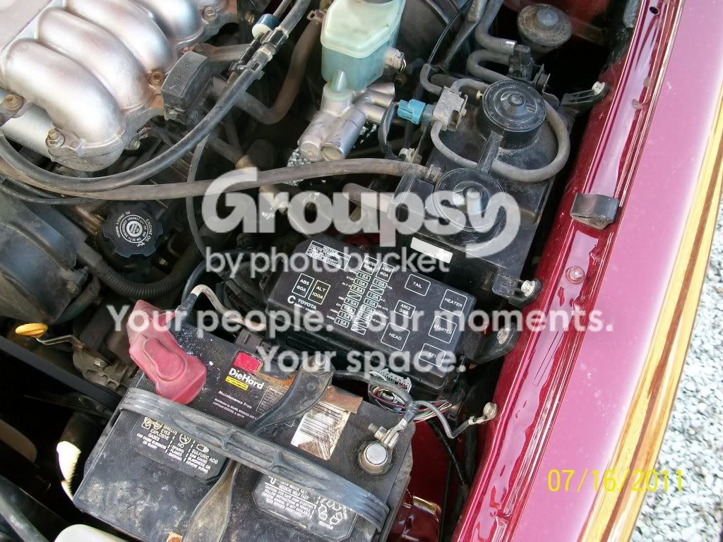

Durk, can you see the two vacuum hoses from these pictures?
I can see ONE, for sure. I think the other is in shadow. It is just to the left of the red positive terminal cover in the second pic. See that ganglia of tubes below the fuse box and just to the rear of the battery? Those go to the two VSV's which are low on the fenderwall. I can also see the vac supply line with the checkvalve coming along the side of the engine on its way there.
Here is what it looks like close up--I'd would definitely make sure the plugs are well set and the tubes are all tight.

I think I found both of the hoses. In two wheel drive only 1 valve, the valve closest to the front of the vehicle, had suction. As soon as I put the lever into 4wd hi, both valves had suction. So what does that leave me with?
You have one very confused front actuator. They expect vacuum on only one hose at a time. Sounds like a bad VSV. See if the voltage to the plugs of the VSV that has continuous suction is going on and off as you go from 2wd to 4wd. If it is, then I would take the VSV out and bench test it. If it doesn't, maybe they missed a connection back on the TC. Quite possible.
