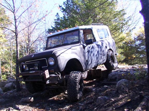

Thanks, again, for all the input. I wanted to make sure I'm clear on something...the V8 4WD is ALWAYS in 4WD? I hope this is not a naive question but on my last 4WD (IH Scout) I had to stop, throw it 4WD, get out and lock the hubs, then go! It sounds like technology has passed me by a little!
Yes the V8 4WD is always in 4 wheel drive. You can buy a V8 2WD if you want.
In the V6 4WD you can choose 2WD or 4WD. As far as the Scout goes, I remember driving one and belive it or not the front wheel drive ran on a chain instead of a drive line, but I am talking about the stone age here.

International Harvester Scout. I found this picture on the web. It was a lot of fun!
