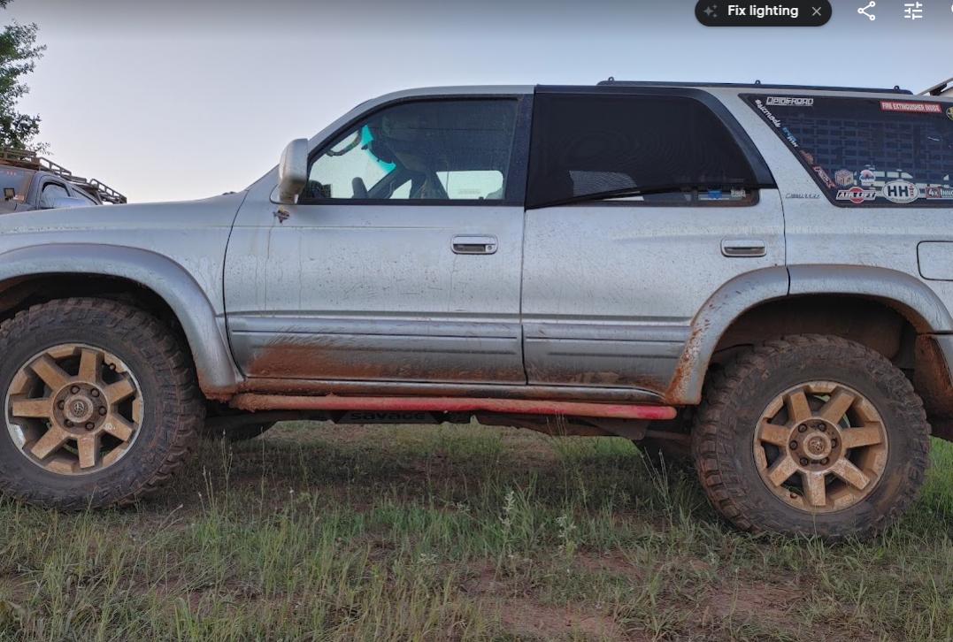

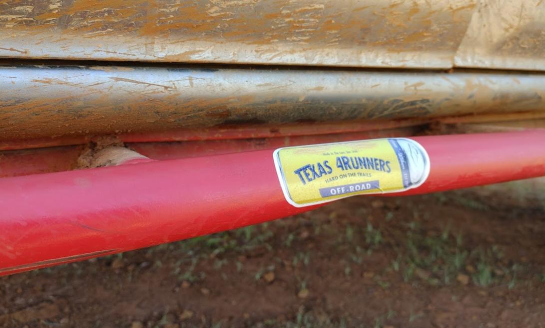

I hate to say it but these sliders are not very strong. Mine keep bending up. Even after bending the passenger side back down and adding the biggest gussets I could fit onto all 6 legs, its bent up again and the kick-out is millimeters from preventing my rear door from opening. One more good hit and I don't think I'll be able to use that door. I had them welded on by a reputable shop so I don't think the welds are an issue. When I purchased these, I weighed them and they came out to 28lbs each which seems pretty light for sliders. I don't think they are a poor product. They are just maybe a bit too light duty.

I wouldn't limit it to one brand. I've seen all brands of sliders do that on different vehicles. At the end of the day the vehicle's partial weight resting on the slider can/will cause some deflecting. Perhaps a thicker steel would help, but clearance is always a worry with sliders.
To avoid the issue without going to 4130 and having it heat treated ($$$$) one should probably just pony up the dough for .188" wall or thicker DOM. The .120-.125" stuff will work, but if you beat on it hard, it'll dimple. Problem is bending the thicker wall stuff is a little harder on equipment. I've bent .188" wall on my JD2 model 3 bender, but it wasn't happy about it. You really need to step up to a beefier bender model if you're going to do that heavy a wall regularly.

For sure. As mentioned, I don't think these are a bad product. They are just too light/thin for hard use.
Next time around, I'll be building my own sliders with a mix of square tubing and .188" wall round tubing. Between my ARB front bumper and these sliders, I'm really done with the headaches of putting inadequate armor on my truck.

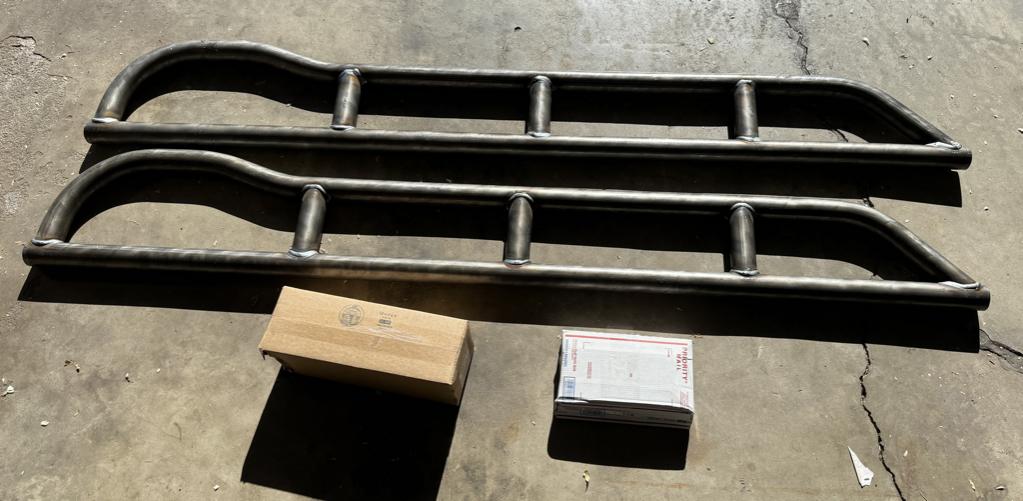

I ordered a set (on sale now) of the DOM round main bar sliders, should be here today.
I want mine to be straight out vs tilted upward and that is much easier with the round vs square tubing. With the round tubing you can adjust the angle to whatever you want.
No plans for serious rock crawling - will use these more as a step to the roof rack.
Arrived in 2 days :amen:
