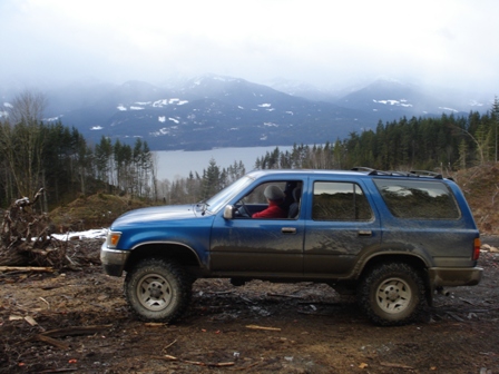

Heres a pic of my 4 wheeling trip.

Without having a picture of the dent, it is hard to say. If it is in the center of the door you could even try a plunger or a suction cup. If you bang it out be sure to have something on the other side to support the metal. Think of the way the dent was made and reverse the process. Start on the edges and work your way towards the bottom of the dent rather than hitting the deepest part first.

Only one pic...we need more! :D
Kind of looks like you are up above Harrison Lake...or Stave...I think I`ve been in that area before.
