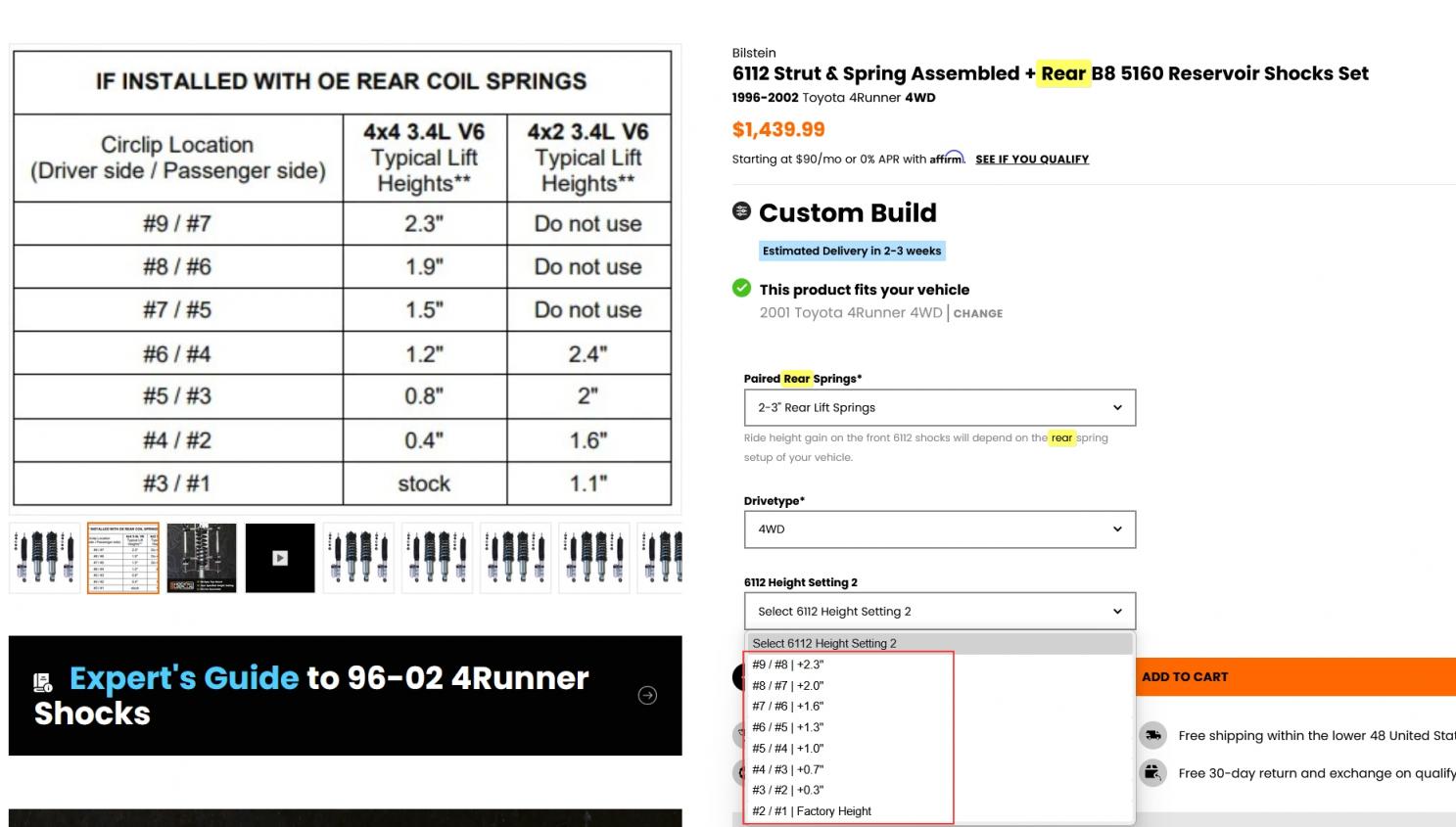

Also if I'm gonna get the 6112 / 5160 combo, (currently have 5100 Bilstein shocks w/ OME 881 (front) and OME 906 (rear))
1. What perch setting should I get the 6112 set at?
2. Is it recommended I keep the OME 906 springs in the rear or change to something else? I like the height its at now, although I didn't measure, i think it's around 2"

Found my old notes: 2001 stock
20" front
20.5" rear
From hub center to the fender
_______________________________
After lift: w/ 5100 OME 801/906
Front: passenger 22.5" driver 22"
Rear: passenger 22.25" driver 22"
So if I want to keep around 2" lift, with 6112/5160 combo
1. What perch setting do I set the 6112 ? #8/#7" for 1.97"?
2. What springs do people use in the rear? Do I keep the 906 or go with something else for the 5160?
