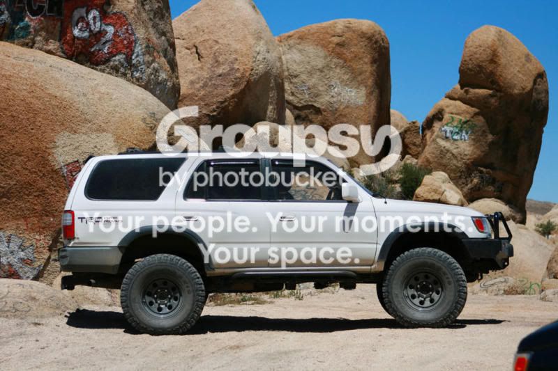

Anyone have pics of 58" sliders installed?
Yeah, you can see how short they are..

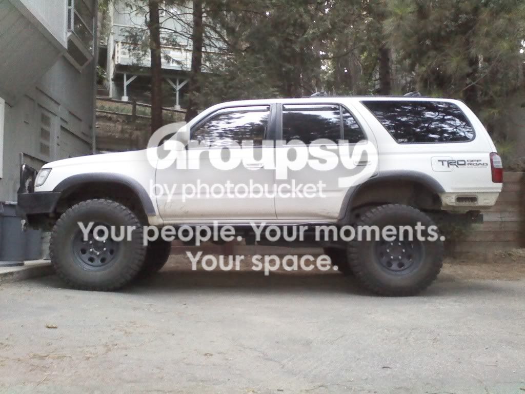

And compared to the 66" 4xInnovatons...

Damn those 58's are cuteeeeeeee :)! I think the 58's are meant for the first and second gen runners, but I agree they should have 3rd gens marked clearly! Well I'm selling my 58s to a buddy and ordering some 4xInnovations then. Thanks for the pic Brian.

So he changed the order to 67" which looking at the 66 & 67" sliders in the pictures here look like they will be perfect.
Cost was $176.00 shipped. and made from 1 3/4"X1.20 1035 DOM tubing and should be here in a week.

Lol. Yeah, pretty hideous.

That's good stuff, haha! Judging by your usual sound advice, I can't believe you even installed those.
Haha, thanks. I cringe at that picture, but it's worth putting up so people can see just how ridiculous the 58s are. :bash:
The reason I put them on anyways is because I had ordered them months earlier and they were just sitting in the box all that time. I never looked at them, I just trusted the website I bought em from that they would fit a 3rd gen 4runner because that's what it said. But that was my fault for not measuring for myself I guess. Then I made an appointment with my welder buddy and when I got there, we opened the box, mocked them up, and realized they were too short. I was going to a ttora Takeover event that weekend and needed some protecton so we stuck them on anyways (although they didn't help much, I still scratched and dented both of my rear doors).
