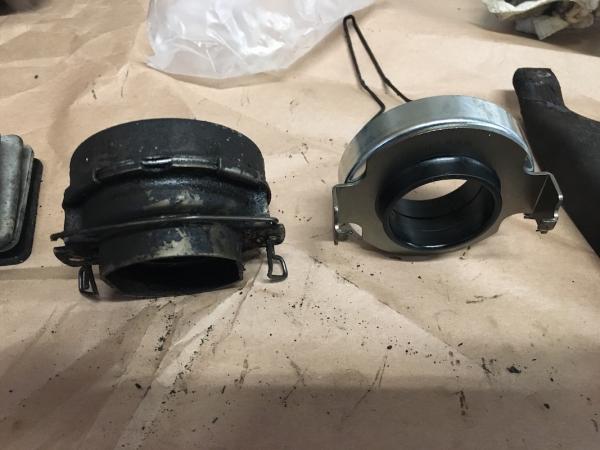

I'm looking over the throwout bearing and it looks to be the wrong one.

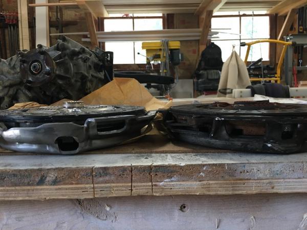

The clutch and pressure plate assembly also look taller than my old when viewed from the side.

I'm assuming the "t/m" on the clutch disc faces the transmission. My old clutch disc is labeled flywheel side..
Did I get the wrong part or do I just get the release bearing from the dealer?
The clutch kit I got is Aisin ATY16070-SS; 167136-MVA
I do know the v6 clutches are different and I believe go in backwards to what is normal orientation.

Yeah hey I 100% agree. The parts I got were Aisin but they were not in the original manufacturers box. I got a good clutch set from Yotashop. Its all back together and I'm back on the road. No leaks or funny noises. No left over parts lol. Clutch is much smoother and lighter than before. I thought my engine oil leak was the oil filter housing but its soaked again so I have to chase that down. I have to say it was very satisfying to feel the trans fall into the pilot bearing and slide home.
