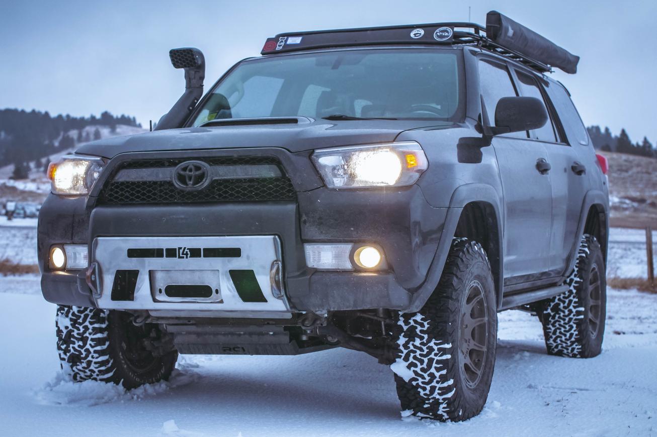

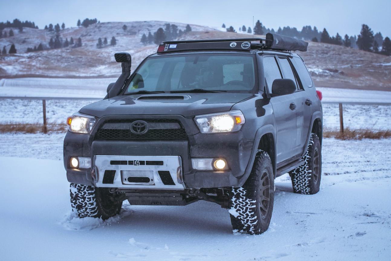

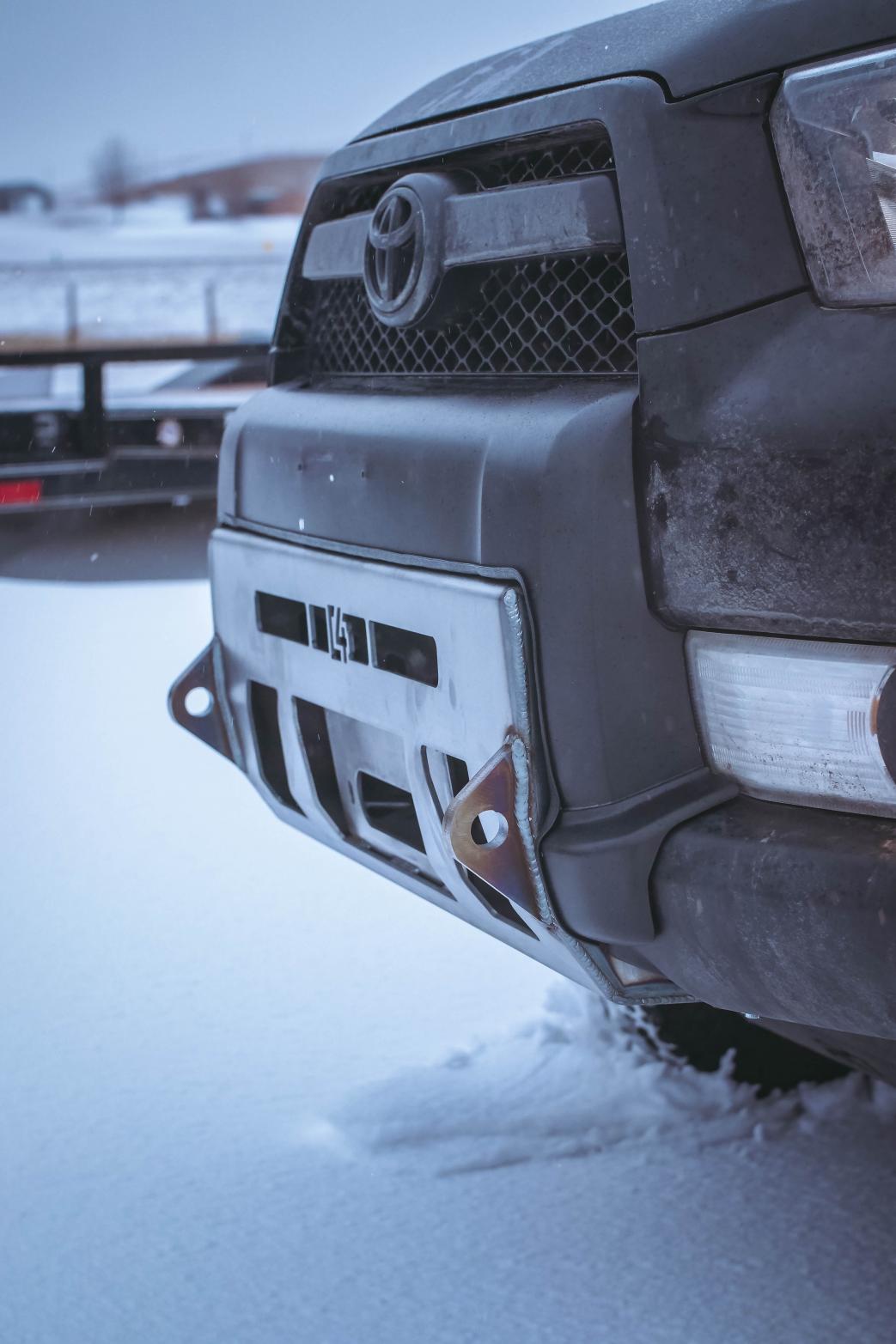

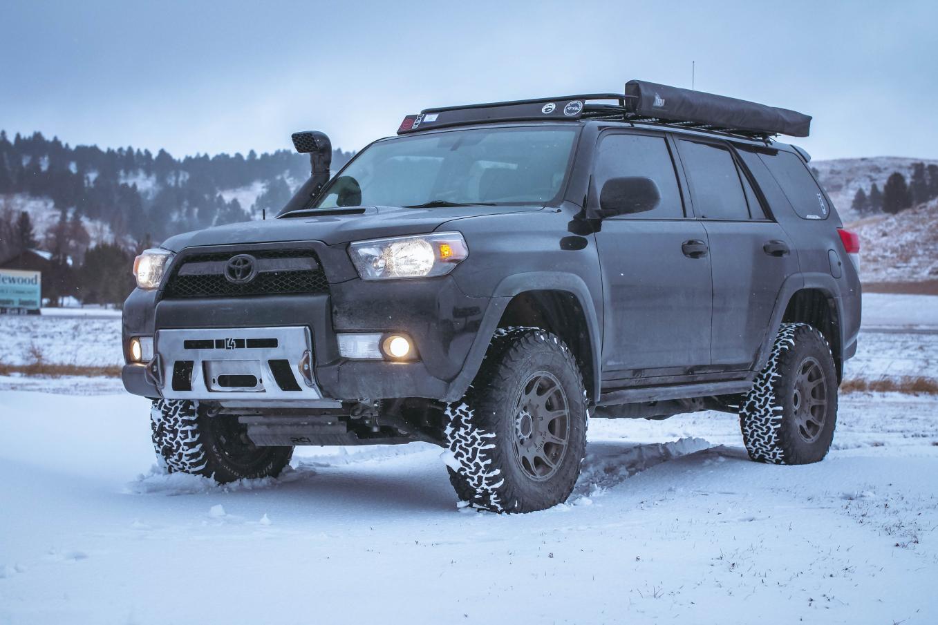

Lol first id like to blame South Dakota and Wyoming winters on the state of my truck. Second, even with it dirty those are pretty pictures.
I just dropped off the bumper this morning for blasting and powdercoating. Was contemplating leaving the Mad Max look to it, but decided that black would look better.
I was able to pull the bumper off by myself in about 9 inches of snow with an 8 month old watching so that should let you know the install/uninstall process was pretty simple. Just pop the bumper cover off and then unbolt 10 bolts that hold it to the frame. Once I get the bumper back and install the winch and clean the outside of the truck ill throw some photos up.
Lastly, huge thanks to Caleb and the guys at C4. They were incredibly easy and awesome to work with and did a freaking outstanding job on this bumper. So glad they were able to get it to this point and cant wait to start seeing more of these around.

Can you guys explain any more about the bumper cutting? Does the trail black plastic need to be removed?
Looks awesome! Cant wait to see it fixed up with black color and accessories like winch and lights.
The bumper cover and trail trim all come off to get cut. Its not a difficult process. We will have an install video put together very soon and posted to our youtube channel.
