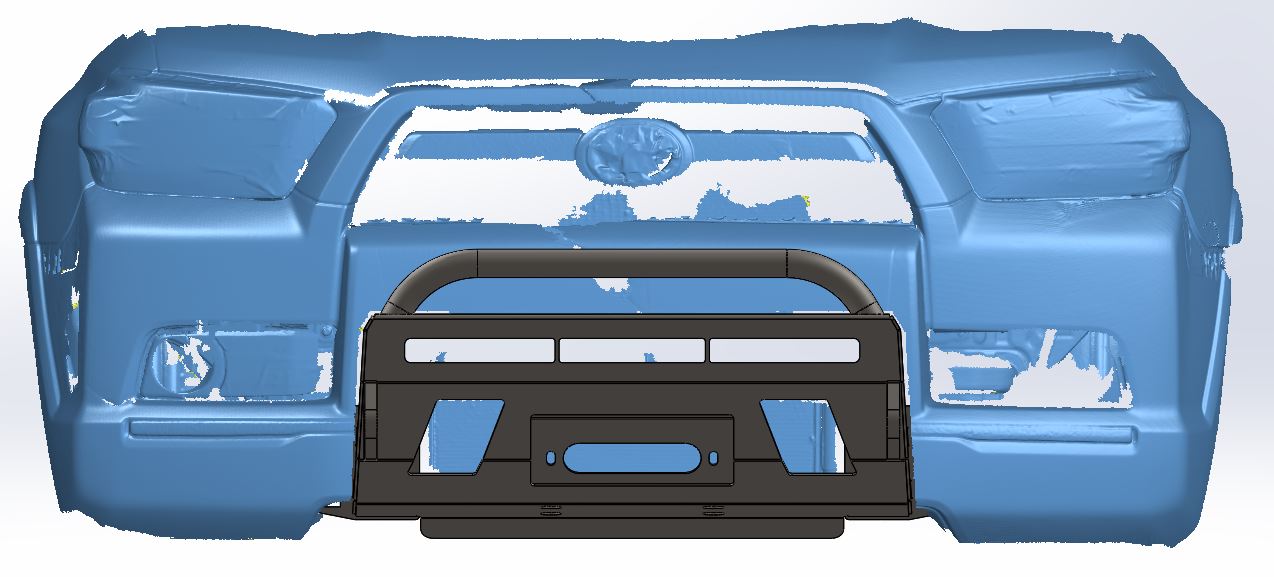

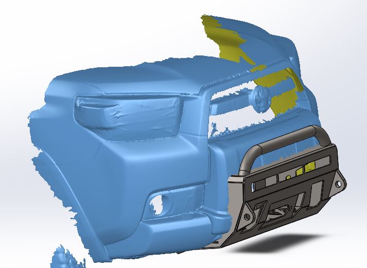

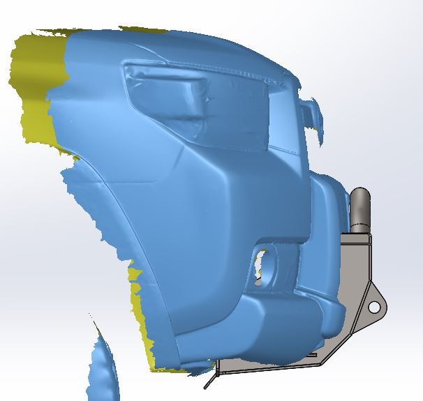

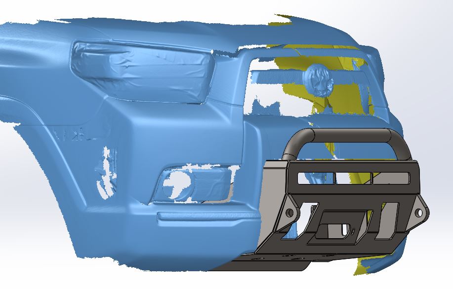

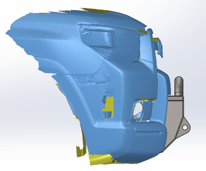

Ok so we updated the drawing and changed the bumper so that a bull bar will fit on top. We had to extend the front face of the bumper out over 2" to allow a bulbar to fit on top.
Our opinion is that it looks bad and greatly decreases approach angle and overall visual appearance. It makes the bumper look very blocky and out of place, sort of gives it that Bulldog underbite look.
Here are the renderings of what it looks like on both the Trail and SR5/Limited versions.
To be up front and honest, I don't think we will offer the bumper with a bullbar option just because of how far it has to protrude out the front of the original plastic bumper.

Low pro angled mini stinger hoop
Would integrating the 3rd gen angled taco bar design bring the bumper back 2 inches?
Thanks for the feedback guys. A Tacoma style bullbar could lessen the bulkiness of the Lo-Pro by possibly about an inch or so. The problem with that type of bull bar is that they are difficult to make. Notching and then bending a piece of tube to fit that outside corner is very tricky and time consuming. There really is no way for us to use a tube notcher or similar tool to fit the ends of the tube because its a square shaped notch.
Our Tacoma bull bars are ordered from a laser cutting company that has a tube laser and cnc tube bender. They have the ability to notch the tube on both ends and laser etch reference marks into the tube so it can be bent on the correct plane each time to ensure a perfect fit.
This process makes sense for our Tacoma Lo-pros because we are ordering 100 at a time or more to keep the cost down. Making a similar bull bar for the 10-13 Lo-Pro doesn't make sense because we know we will never be selling nearly as many units compared to our Tacoma Lo-Pros and 14+ Lo-Pros.
So there is the long version as to why that type of bull bar doesn't make sense for us from a manufacturing standpoint. Lets let the thread continue for a few days to see what other responses we get about making the bumper stick out enough for a bull bar or not. As im sure you guys have realized, the no bull bar design is definitely where our vote is. It fits much better with C4's sleek function and styling. The 10-13 plastic bumpers already stick out and hang down farther than the 14+ bumpers so why make the Lo-Pro protrude out even farther than it needs to?

Does anyone else feel both designs favor the SR5/Limited over the Trail in regards to streamline and fitment? I am comparing the side profiles and it seems there will be a loss of approach angle regardless of bull bar for the trail. I know its going to be impossible to please everyone...Just my $0.02
Yes the Lo-Pro does offer a tighter looking fit on the SR5/Limited because the plastics on those stick forward and down more than the Trail.
We do not plan to offer two different versions of this bumper just to fit Trail or SR5/Limited so we did the best we could to make the Lo-Pro fit well on all both trims.
