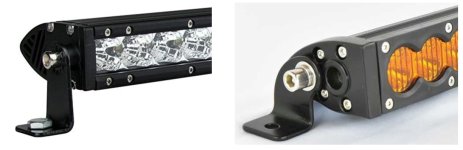

Gotta be honest though - it's a cheap lightbar and not quite 25" from end to end. It's more like 24.5". I didn't spend much time looking at it, but anyone a bit perplexed on how their lightbar will mount close to the opening? I'm probably going to have to fabricate the brackets a bit. Not worried, but maybe I'm over complicating it?
I believe anything that matches the short bracket legs will work, check out the other additional pictures, I've seen some really close ones that matches these on ebay. To be honest I think most of these models are Chinese (Higher quality) made and I'm not knocking them for relabeling and selling it as their brand.
White LED Light Bar - 25 inch Single Row by Extreme LED
Off-Set Bracket
Yeah agreed. I need to off-set the mounting bracket a bit and we'll be good.
