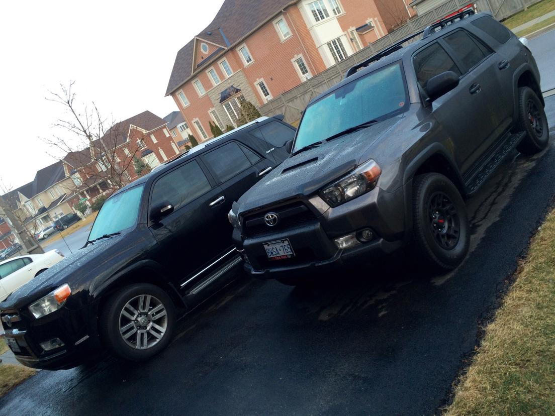

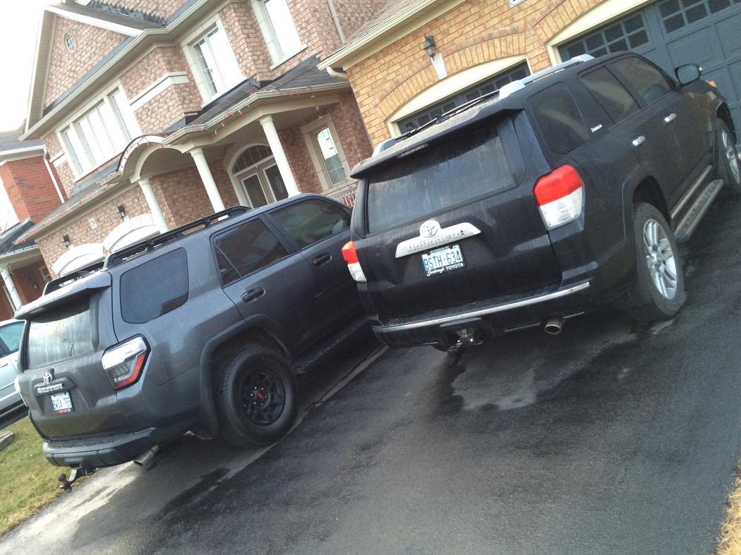

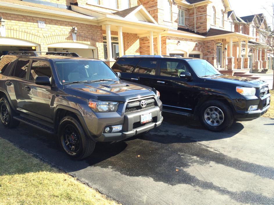

Hi all,
I am sorry if this has been answered before but I didn't find any specific answers after digging many posts/pictures.
I have a 2010 LE Canadian version for the wife and 2011 TE version Canadian for myself. I am satisfied wit the JBL sound system in the 2010 but not happy at all with the 2011.
Here is what I would like to do....
- keep the stock look (with two round knobs) and therefore I assume that I have to keep the ugly orange lit stereo
- change all speakers to something really good
- do NOT want to put any subwoofer
- put in-line amp (smallest possible of course to fit inside the dash) to amp all speakers (not just 4 in the front doors)
- not pull extra power cables fro the battery
- do it myself if relatively simple job
- keep the party mode function if possible (the 2010 LE almost has no affect of this function but the 2011 TE has a big affect of this function)
- do not care about NAVI, happy with the backup cam in the mirror
Please advise.
- your comments/concerns/questions
- please sketch a simple wiring diagram if you can and upload it
- list of parts that I will need to do the job including wire harness etc that I need
- i want to go Alpine SPR-60C speakers all around if I can, if you recommend any that would be great
- target audio performance like the 2010 LE or better will make me happy
- budget less than $1500
Thanks in advance.
