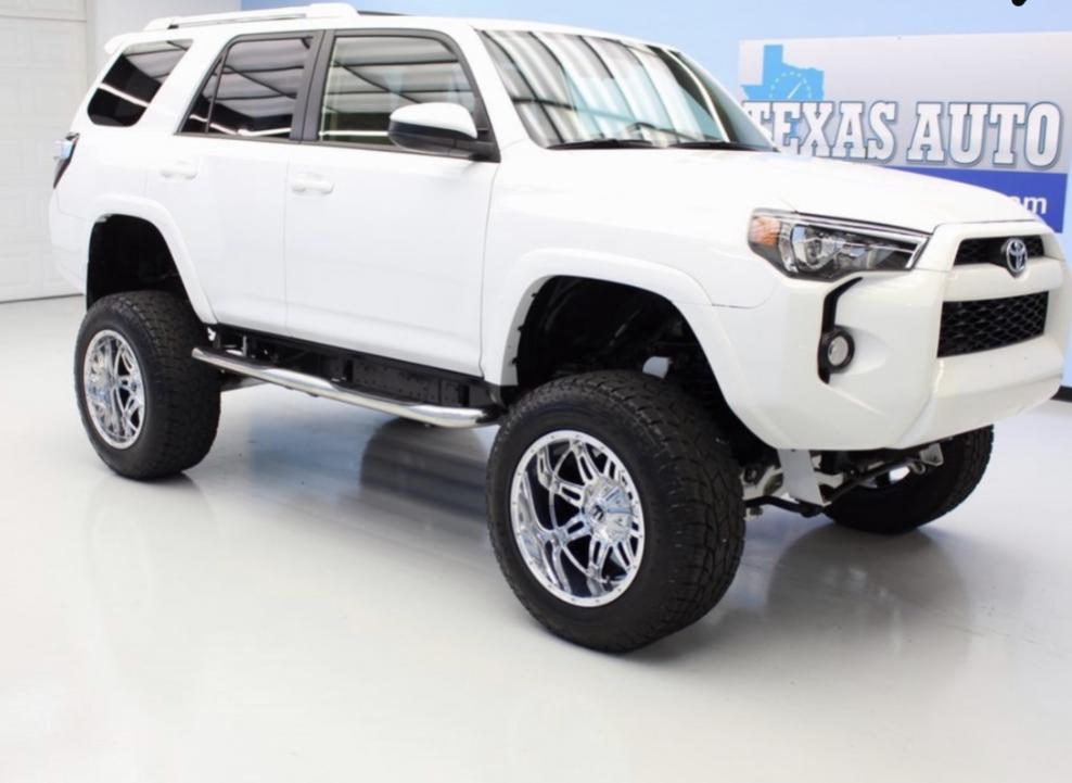

I could be wrong but I’m pretty sure this is the questioned 4Runner, I lived in Houston at the time of Harvey and saw this after Harvey, and sold not long after. I happened to screen shot it, I know this an old thread but anyone coming across this wants to know what it looks like
