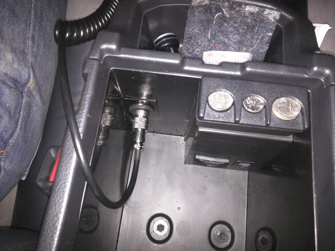

On both my trucks, I run a cobra 75 mounted under the center console with the plug running into the console itself. I run 18 feet of coax under the seat and carpet over to the kick panels on the driver's side, then fish it through the quarter panel into the roof and out to the hatch where it meets a diamond k400 mount with a heavy duty spring and 2ft fire stick.

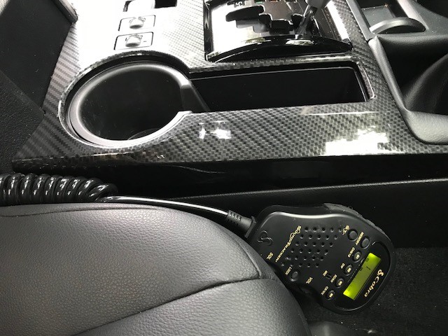

I just installed a Cobra 75WXST 40-Channel CB Radio (amazon), where the entire guts are in the hand set, with just a tiny connector box under the passenger seat. The mic's stretch cable nicely rests in the groove between the passenger seat and the center console, nearly invisible. The CB puts out the full legal 4W, like any other CB.

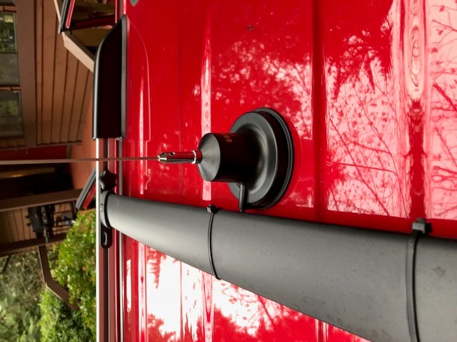

I put a WILSON 305-38 300-Watt Little Wil Magnet Mount Antenna, 3' long, (amazon) just aft of the sunroof, and routed the cable along the roof rack and into the rubber liner in the roof rack track groove. Unbolt the rack foot, pull out the rubber thingy, and you will see that it has nice grooves running lengthwise, and the coax cable fits *perfectly* into the groove. Use a pen, screwdriver or trim puller to winkle the coax into the outside groove, all the way up to the windshield. Re-bolt the roof rack foot to pin it back into place, being careful not to crush the coax. Run the coax down the windshield side groove, where, again, it fits perfectly, down into the engine compartment.

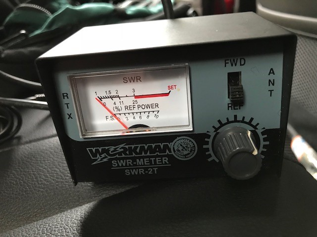

Get an SWR (standing wave ratio) meter (amazon, $20ish) and connect it inline between the CB junction box and the antenna coax, and follow the directions to tune the antenna length. BUT WAIT! The Lil Will mag mount antenna has one idiosyncrasy. If you seat the antenna all the way down into the mag mount, you will short it out, and your SWR will be a terrible 3.5, and you risk blowing up your radio. (I tried this with two separate Lil Wills.) Seat the antenna, then, pull it up 1/8 of an inch from the bottom of the mount, and tighten the set screw. Presto, no short, and your SWR will be down at a healthy 1.3 or so. Now you can shorten the antenna in 1/4 inch increments with a hacksaw until channel 40 (initially high SWR) and channel 1 (initially low SWR) are about the same (perfect.) But always remember to seat the antenna 1/8 of an inch above the bottom of the mag mount.

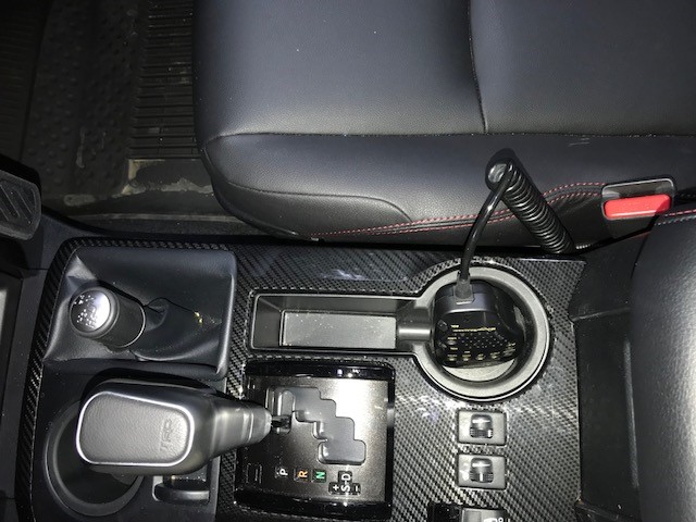

This really is a beautiful installation, with only the mic visible, all the controls in your hand, and no dashboard mods at all. Plus, that CB model is plenty loud, and you don't need an external speaker, although it takes one. When you are using it, let it lie in the passenger's cup holder. When you are not using it, clip it to the mic mount, which you can attach to the front valence of the passenger seat so it moves forward and back with the seat and is out of the way of legs.
I really love this "stealth" installation. If you want pics, ping me back and I'll post them.
Lil Will antenna, mag mounted...

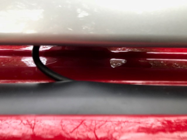

Route the coax into the rubber strip's channel...

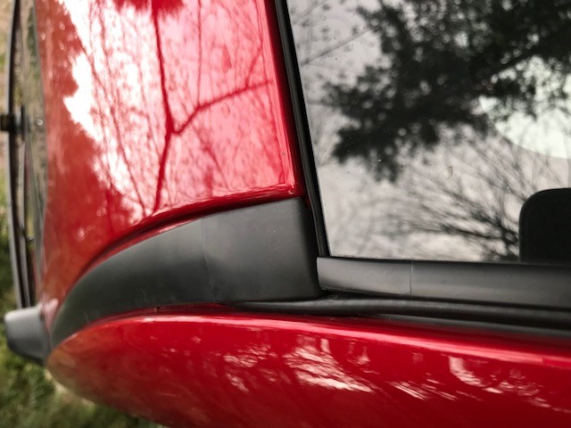

And down the windshield channel into the engine bay...

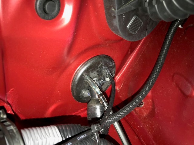

Through the firewall...

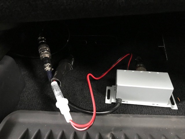

Under door's kick step, then under the passenger seat carpet...
