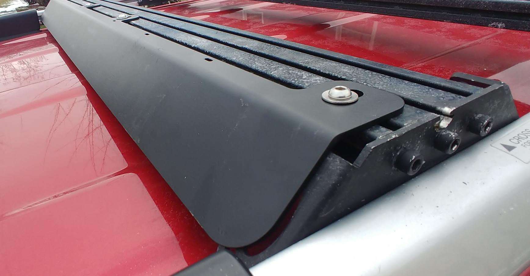

How far off the roof is the top of your crossbar? I had to add spacers to keep the fairing from hitting the roof. I think mine may be a bit lower than these crossbars
I'm not sure. I think the measurement is in this thread somewhere, though. A few spacers are fine if it helps bring down the wind noise.
Same way I felt. It cuts down wind noise a lot. I 3D printed my spacers. They are 4.5MM thick which leaves a 2.3MM gap on my particular setup. No whistling and lower wind noise
I recently received the LFD fairing, but haven't had a chance to install it yet. A quick test fit told me I won't need any spacers, tho. I'll report back after a couple of upcoming holiday road trips.

As far as the noise, with the RTT I really don't hear any more noise, even at 70 or 75
Finally got the LFD fairing installed. I didn't have the hardware on hand to get it done before a long road trip, but I have tested it a few times on the freeway and it cuts noise significantly up to ~85MPH. I removed the crossbar to add the fairing, and it only took 15 minutes or so.

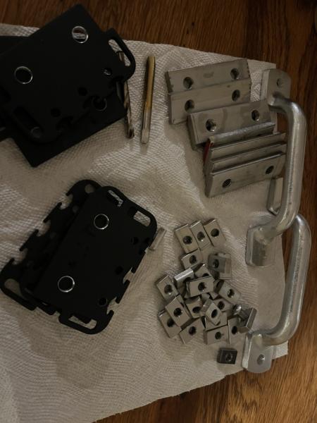

I finally found the time to fool with this stuff.
I made large T-nuts for the mounts using stainless 1"x1/4"-3" bar and threaded them for M10 bolts. These fit the 4Runner side rails perfectly and are certainly strong enough and rigid enough, to a point where the mounts don't need the bent angle design. The Roofnest tent to sit on top weighs 160 lbs.
The T-bars themselves were threaded to M6 for $2 an end, can't beat that.
The truck is metric, no sense in mixing it up with SAE hardware.
BTW, all 3 were only out by 1/32"
While I was using my buddy's mill, I also made a bunch of ss T-nuts for use on the aluminum cased Roofnest tent.
Even the store bought plated ones started to show signs of rusting in just a few days.
