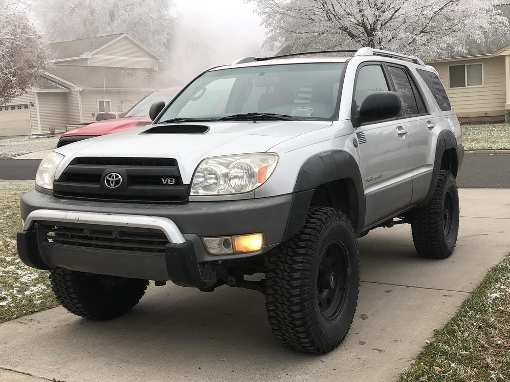

I’ve had both (2015 TRD PRO and now a 2003 sport w/ V8) and i feel like i can be rougher with the 03. The 5th gen had the locking dif and other modern technology but overall i prefer the 4th gen. It’s all personal preference and what you wanna pay for.
