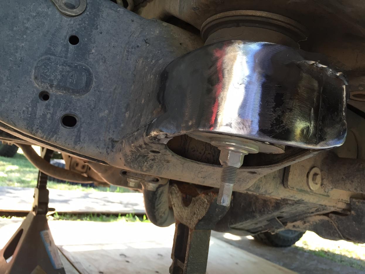

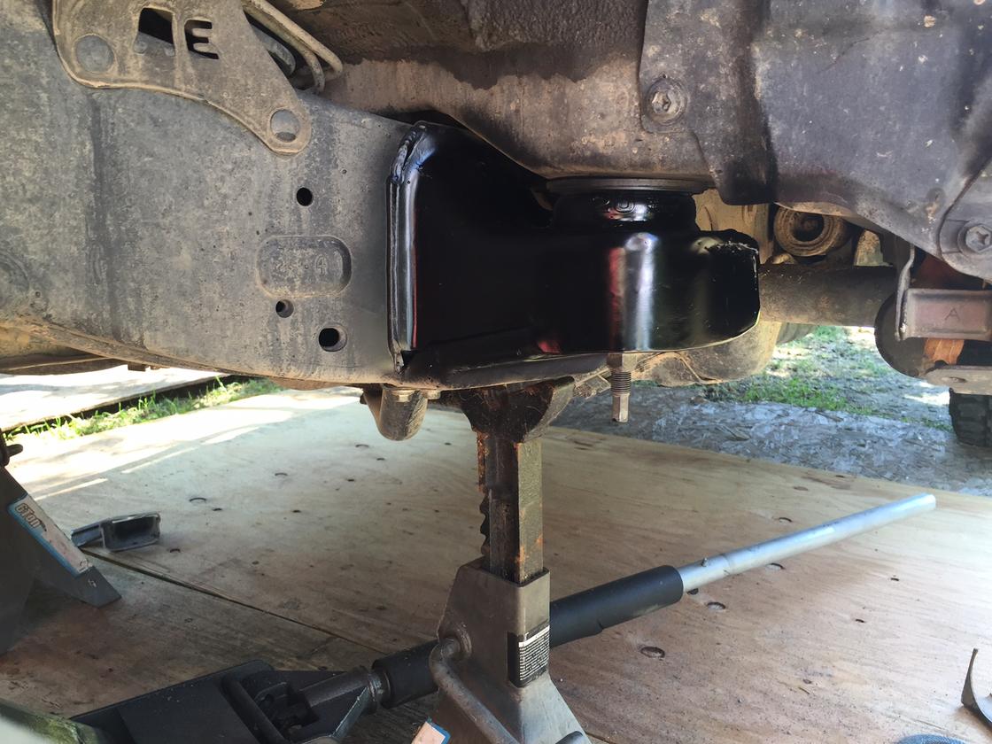

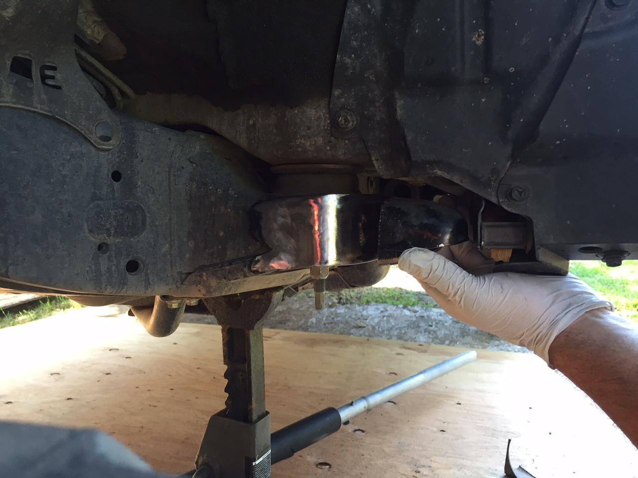

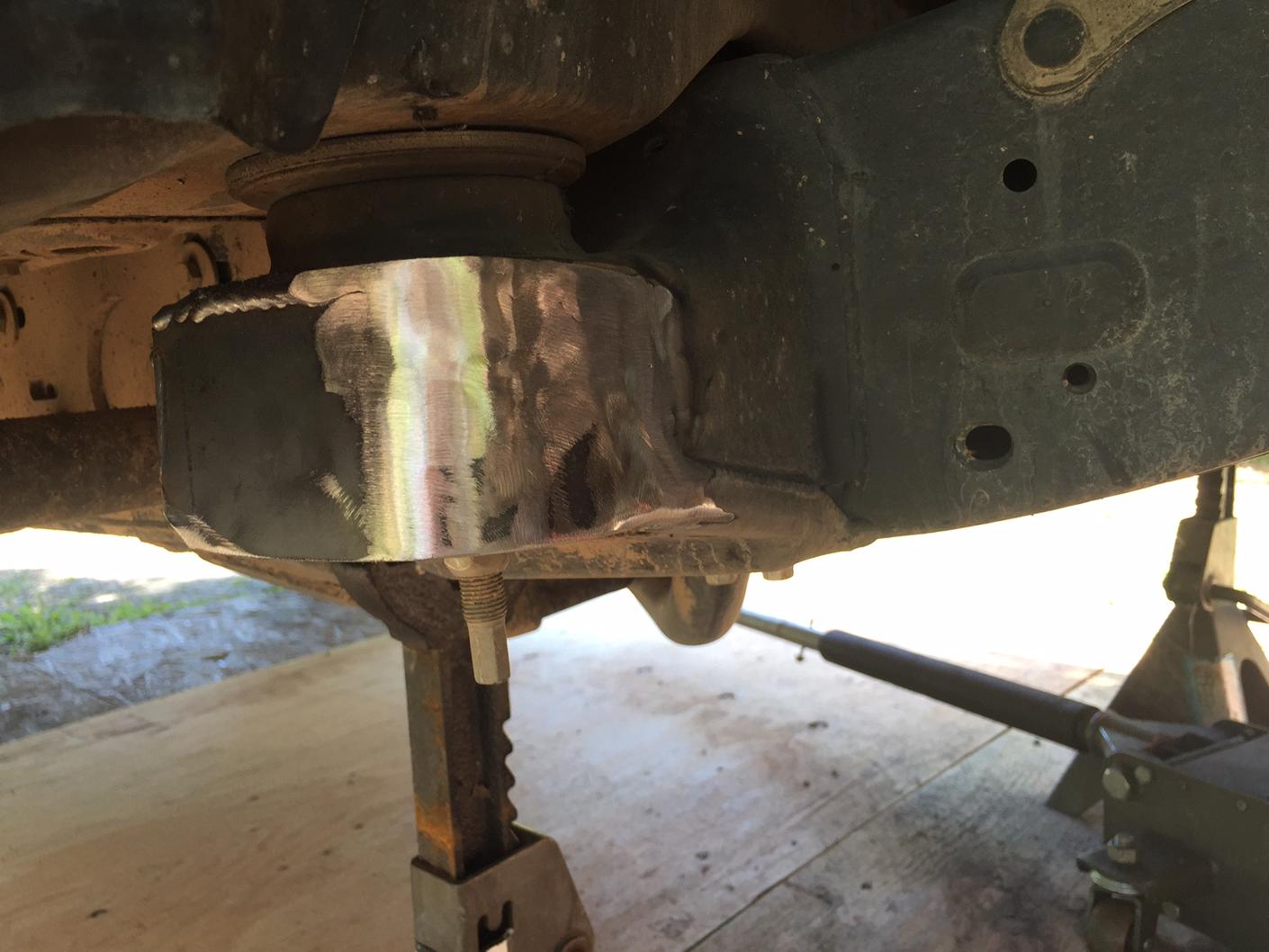

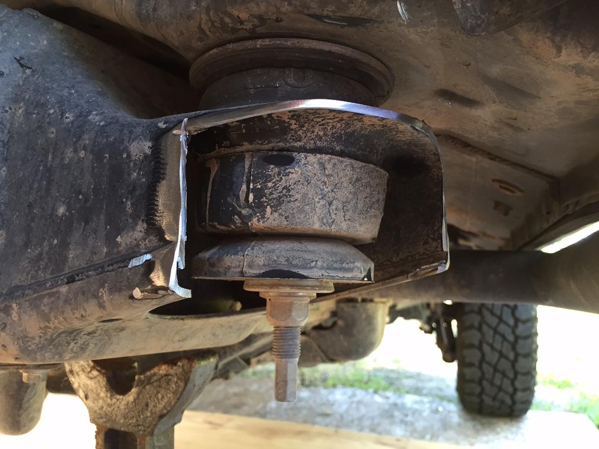

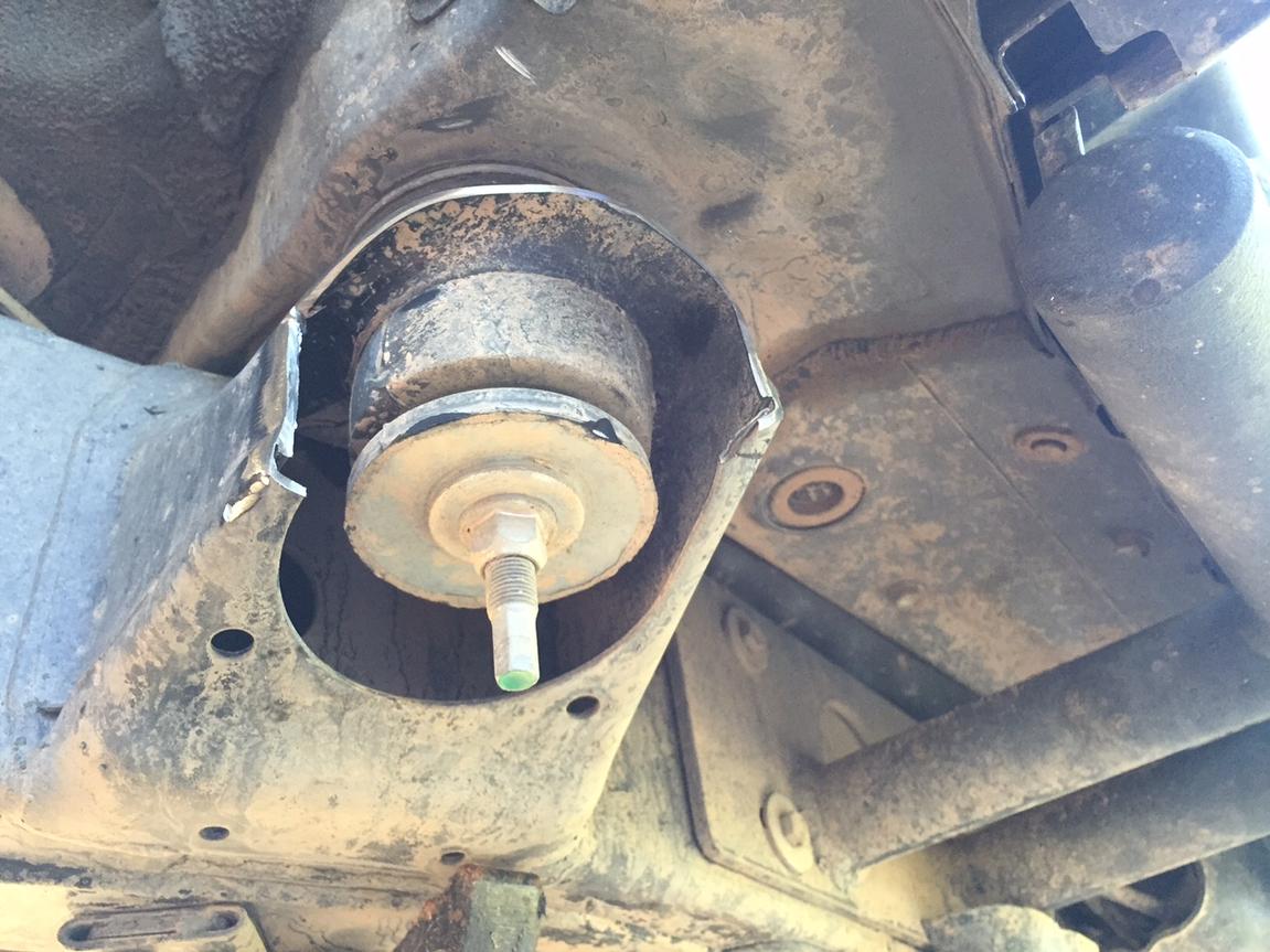

The need to trim the frame body-mounts/outriggers when fitting larger tires is pretty well documented here but there doesn't seem to be a whole lot of pictures. For those interested, I thought I'd throw up some pics from my experience doing this today. I met up with T4R member the_josh for this one. I'm really happy with his work and how it turned out. Functionally the whole outrigger has been shortened and capped with a curved-to-fit metal plate. Aesthetically it looks factory. It's not too difficult, just requires the right tools and the skills to use them. My tires used to rub when turned during up-travel, this opens up a lot more room to breath now!

Good work and thanks for the visuals. Definitely a must do for tires larger than 33s. I will consider this diy if I happen to get excess rubbing from larger tires.
great pics! nice to see it clear and up close.

Yea I know how that goes, I was in the same boat. Luckily the_josh is local to me so I was able to employ him to do the work. Maybe another member near you can help out? I've seen a lot of gnarly looking body mount chops so I was psyched to find someone who's work is so clean.

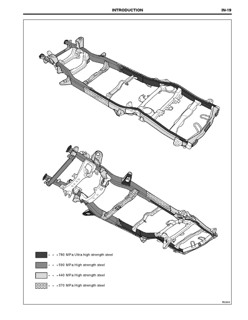

While the stock mounts work fine with the factory tires, I never understood Toyota's rationale for the odd body mount perches and resultant interference issues with larger tires. I can observe no appreciable structural advantages to the stock config to your modified setup. Maybe one of the many engineers around here can chime in with a rational explanation for the factory perches? :)

It's to prevent/reduce the front wheels intruding on the cab in an offset front end collision. The lower part of the mount is made of 780MPa ultra high strength steel (highest strength steel used in the frame).

Meant to help protect and absorb some of the energy in a overlap crash like this would be my guess on why they used such high strength steel....

Any reason to cover the chop instead of just leaving it open/exposed? I would think you would paint where you cut, but does the welded plate really make a difference other than aesthetics?
