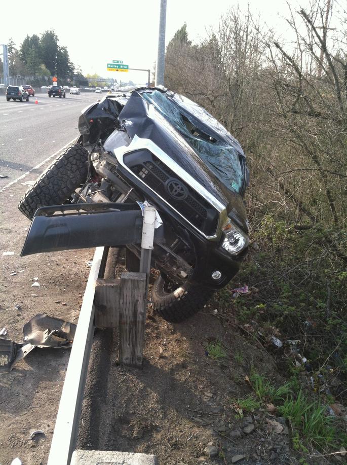

Last year I had a guy slow down in front of me as we were merging onto the freeway,versus accelerating to merge onto traffic. I was already in the process of getting over when he slowed down. I hit the rear of him doing 60. It threw me into a spin and 4 consecutive roll overs. Here's an after picture. .. uploadfromtaptalk1431882343435.jpg

jesus, glad you're ok.
Thanks. My 4 yr old son and I walked away. I still took him to the er as a precautions but got a clean bill of health. I have interior pictures to, Whenever I share them people are amazed I walked away, don't need a Subaru to live. ..Toyota 4 life.

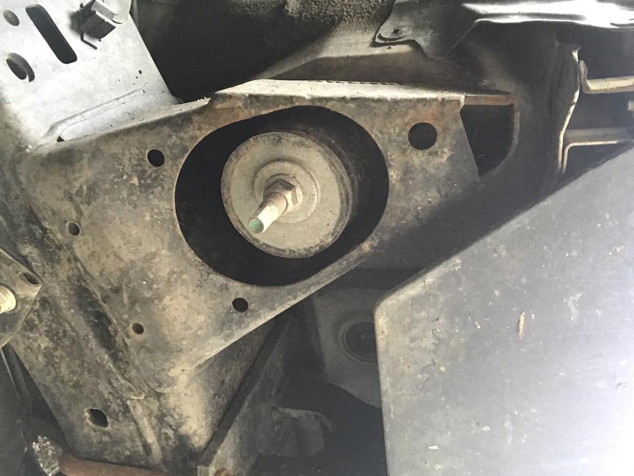

OP, Where did you get the kit?
It wasn't a kit, the fabricator formed the new plates specific to the cuts at the time of install. I'm on my second 5th gen and used Relentless body mount chop plates/kit this time around.. they work but the custom formed ones look better and are higher clearance. Nothing against the quality of Relentless. I think Metaltech and maybe Allpro sell plate "kits" as well but you'd have to check, I must have gotten Relentless cause they were a better price at the time.
Thanks for the quick reply! I appreciate the info.
[MENTION=96425]JSparky[/MENTION] Seems like with the BMC, you will gain lateral articulation clearance, but from that angle, the vertical articulation is hindered by other objects. This makes me question the feasibility of having sufficient up travel with a larger tire such as a 34"...
So I am looking into this for tires I am planning on getting in the future. The mount gets chopped off and a new plate goes on there the let the bigger tires move and not rub or hit? Right?
Yes, depending on the tire size. The standard body mount is good for most tires up to 34", after that, from my understanding, you need and even more aggressive body mount chop, but at that point it's probably that least of your worries with other things that need cut/trimmed.
yup, no more rubbing on the body mount.
