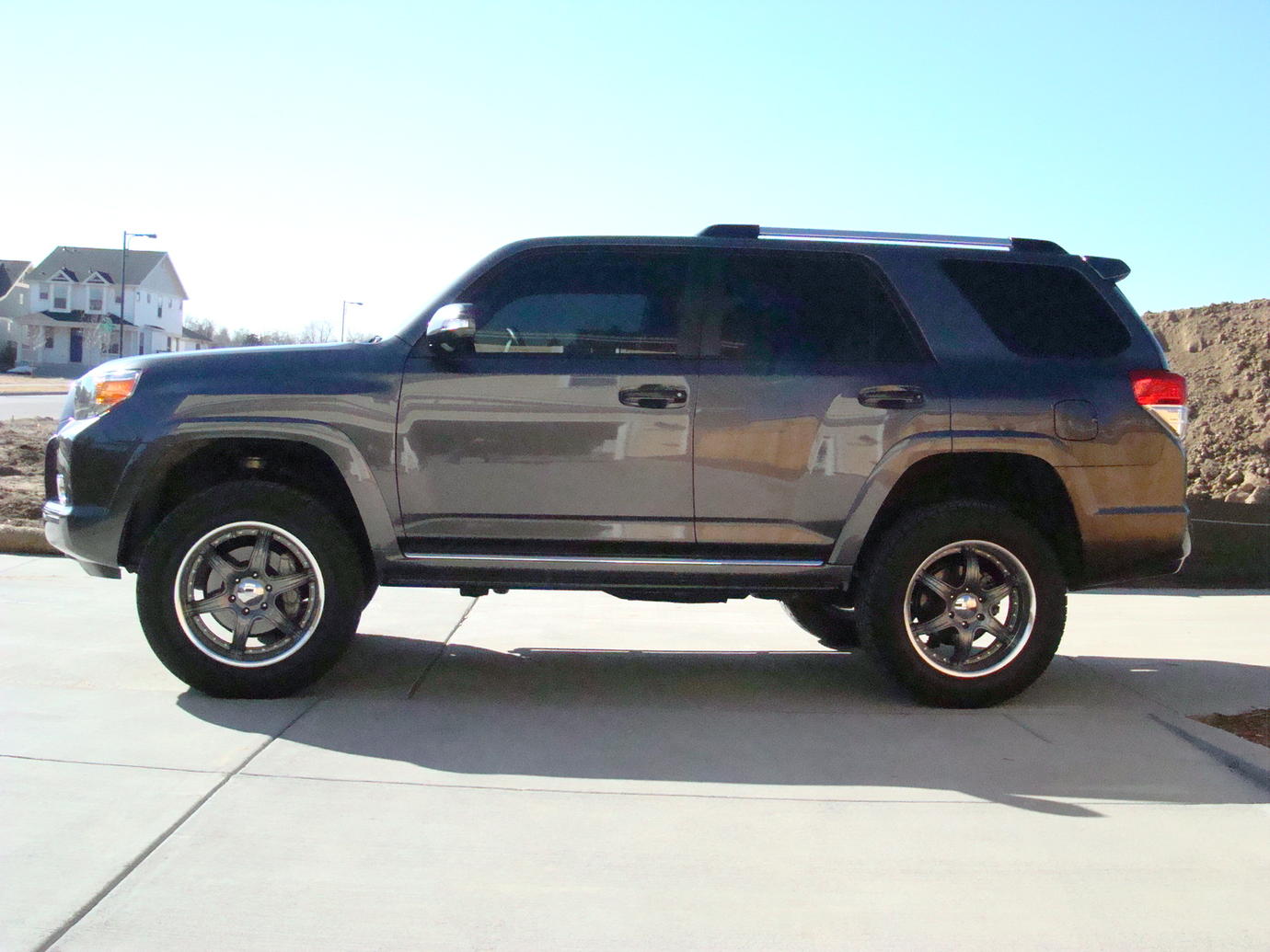

PICS, I dont think I have seen anyone on true 33s yeat, just a bunch with 275s

Ok, nice, I like that look. What is that setup you have there?
Toytec 3" spacer in front, Toytec 2" rear springs. Running 275/60R20, which is 33X11.5.
I plan on new coilovers but will not look any different, when I put those on, same amount of lift.
