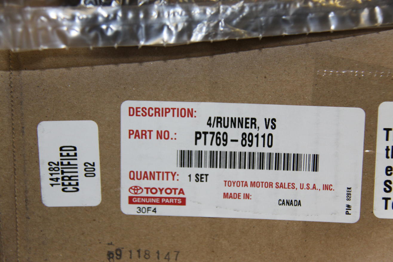

I bought a set from my dealer, tried to install them and ended up having the dealer install them for me, tech had to drill holes.
Here is a pic of the box

You need to specify year and model, there are variations.
Indeed, there are various flaps, depending on which model (Limited, Trail, SR5) you have. All have different part numbers. You need to know which flaps will fit your 4Runner. They're quite easy to install if they are the correct ones. A complete set from Toyota should include any necessary hardware that isn't already on the truck.

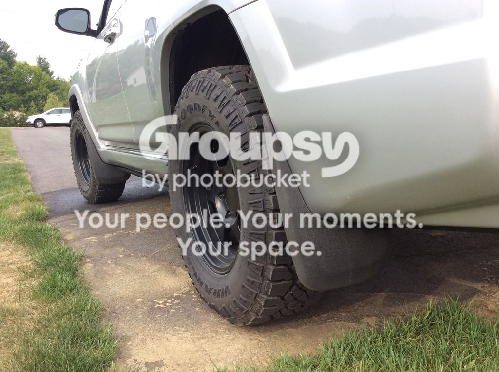

I bought OEM Toyota mud flaps for my 2016 Limited on eBay... I have noticed a lot of dealerships have eBay accounts and sell parts for huge discounts. I paid $50 (shipped) for all 4 mud flaps from a *Toyota dealership*, which is a big discount from the ~$120 (?) MSRP. (I also have been buying other accessories from dealerships on eBay: roof cross bars, all-weather mats, etc. Huge savings for OEM items!)
Anyway, the OEM ones were pretty easy to install... probably took me an hour to do all 4, and a good chunk of that time was spent cleaning the winter sludge off the areas and learning how to remove the plastic clips without breaking them. You do have to drill 4 small holes in the liner which I was a little nervous about, but it was super easy. Some of the screws are in an awkward place if you're using a regular screwdriver, but I just put a philips bit into my socket wrench and didn't have any problems. (Didn't have to remove the wheels or anything like that.)
