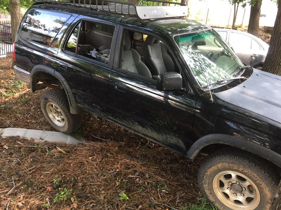

I ended up going with FJ rears after seeing the pair side by side. There wasn't much difference (maybe 5th gen 1mm thicker?) so I went with the less used ones. Unfortunately I don't have any measurements for you but can show you what it looks like with FJ's springs all around and Bilstein 5100 (first notch in front)
2010 springs
The 4runner pictured here is not mine but I sold these springs from a 2010 to him. He said about 1 in in the front and 2in rear. Said ride was substantially improved. He cut the front struts and re-welded them to make them fit. He said it wasn't worth the work due to the minimal improvement for the strut. He did use the rears as bolt on though. I'm going to be doing mine next weekend with FJ rears from a 2013 and fronts from a 2017 4runner. I'm doing 4runner 5100's all around. I'm using the energy suspension isolators rather than the stock rubber ones which measure about 3/8" thick. Not sure if I'm going to go on the bottom notch or first notch of the fronts yet. The FJ springs I have measured about 1/4" taller than the 4runner rears I sold.

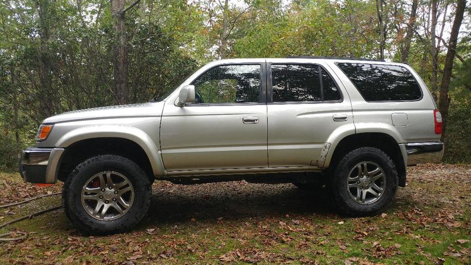

I’m rolling with 2016 SR5 coils in the rear, and billy 4600’s. Great height, awesome setup. Not too stiff, not too soft.
Looks great! Aren't they awesome?
They are a perfect spring if you're looking to sit at that height. I loved them on my '97 when I lowered it to "stock" height to sell.

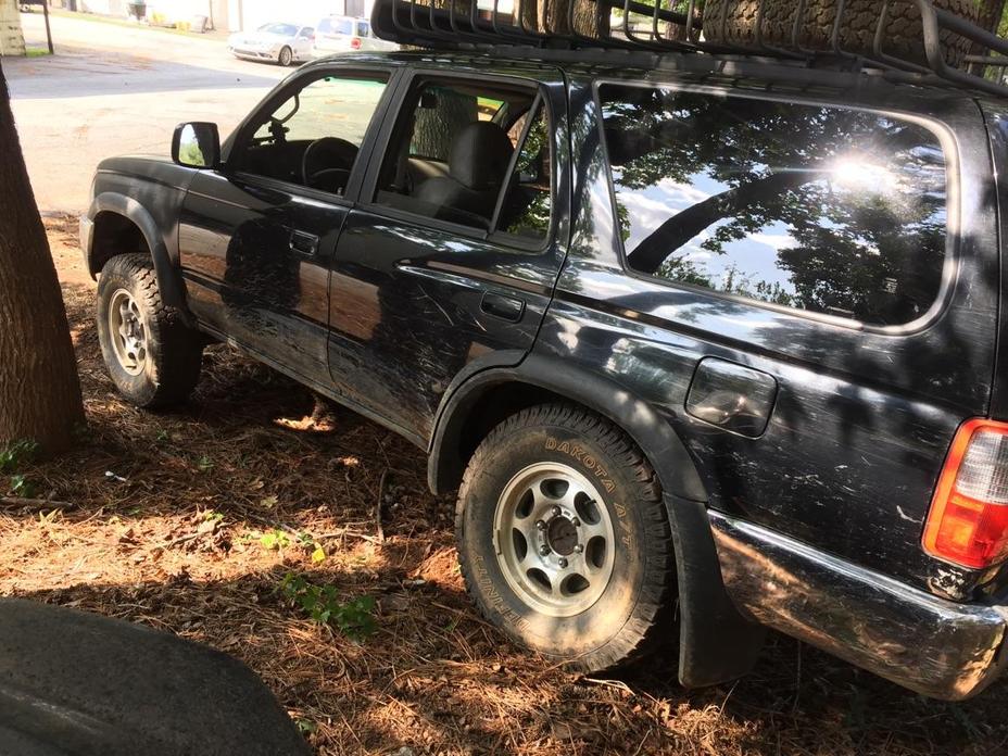

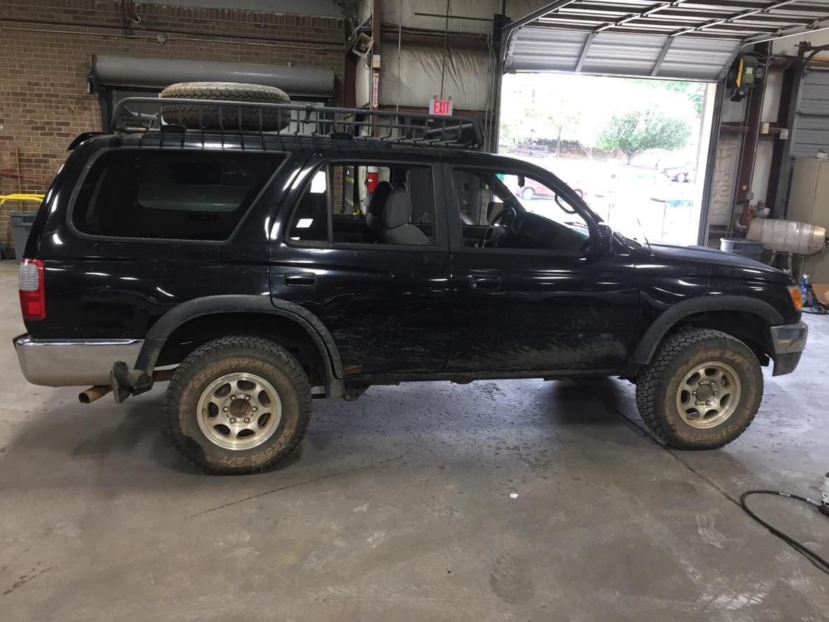

Noticed I never added a picture of how it sits with 5th gen springs front and rear with KYB shocks.
How much lift did you get, or what is your current hub to fender lip measurement ?
