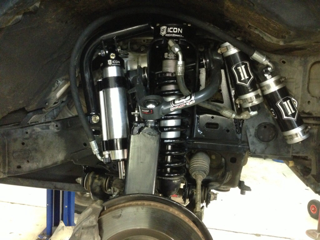

I decided to upgrade - I put remote resi double bypasses in the rear - which by virtue of having a bypass have a built-in bump zone. I had my front coilovers rebuilt with heavier 700lb springs to better support the extra weight and had the shocks revalved for those springs. I also added secondary bypasses up front to add the bump zone and to be able to fine-tune the compression and rebound in the ride zone.
This setup really works for me. Relative to my friends with lesser setups I am able to cover the same terrain much faster - the truck just eats it up without transferring nearly as much of the hits into the cabin. I also am really pleased with the on-road handling as the truck is still a daily driver.
