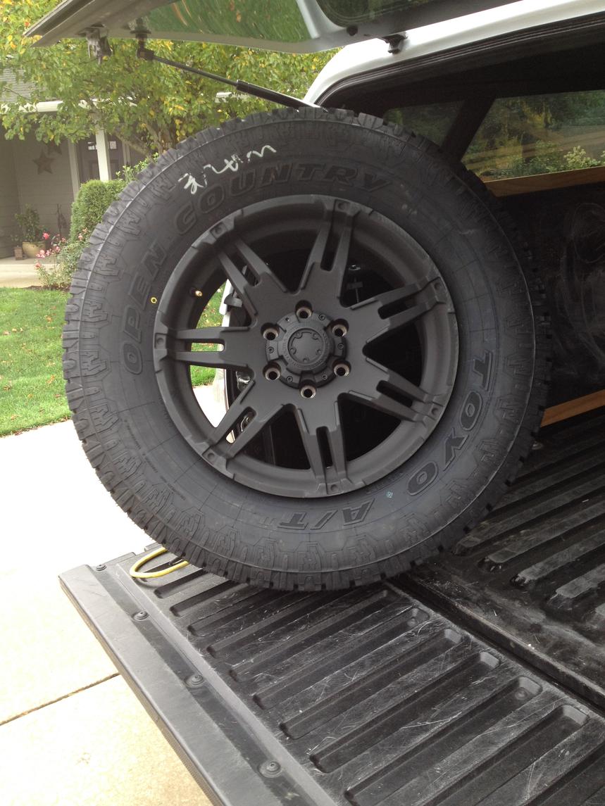

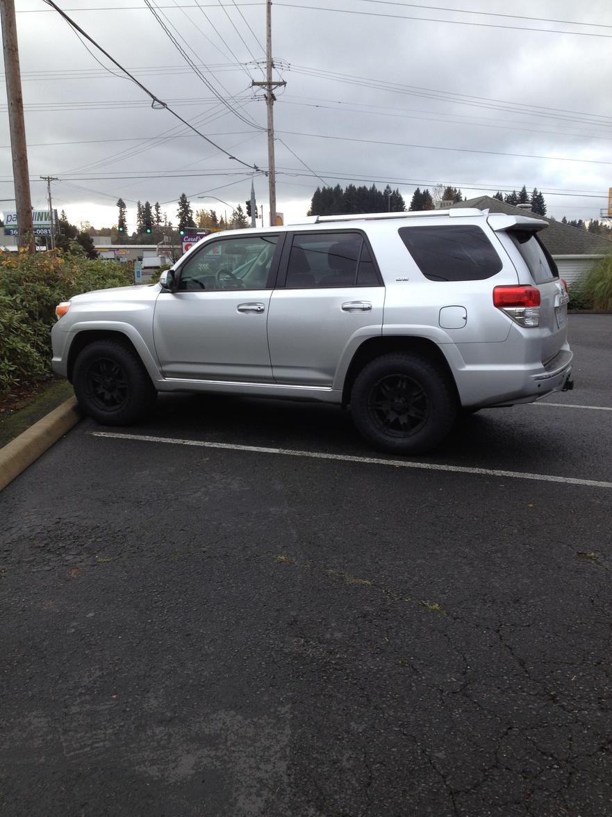

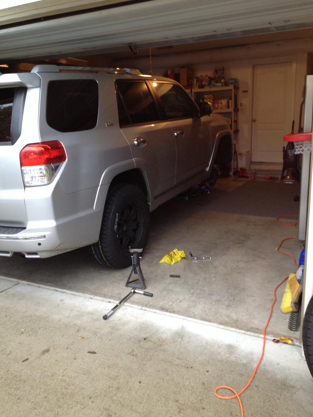

I'm throwing on 18x9 ultra gauntlets with 275/65/18 toyo AT2. Keeping it stock height. We will see how she rides. Hoping for no rubbing ( it will piss the wife off). But it sounds like i should be ok. Doesn't see much off road except for maybe logging roads. Let ya boys know and i'll get some pics up.
Got them on last week. Little help from my neighbor (full shop). So ya here's the pics.
