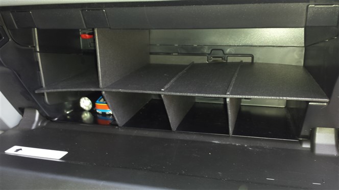

Thanks Salex! Received mine via Amazon Prime, in one day. Still have more to add.

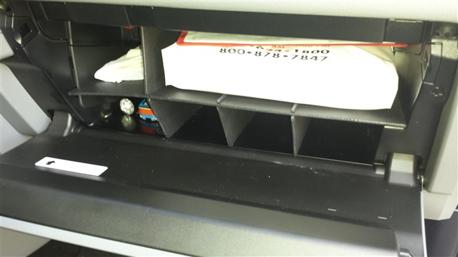

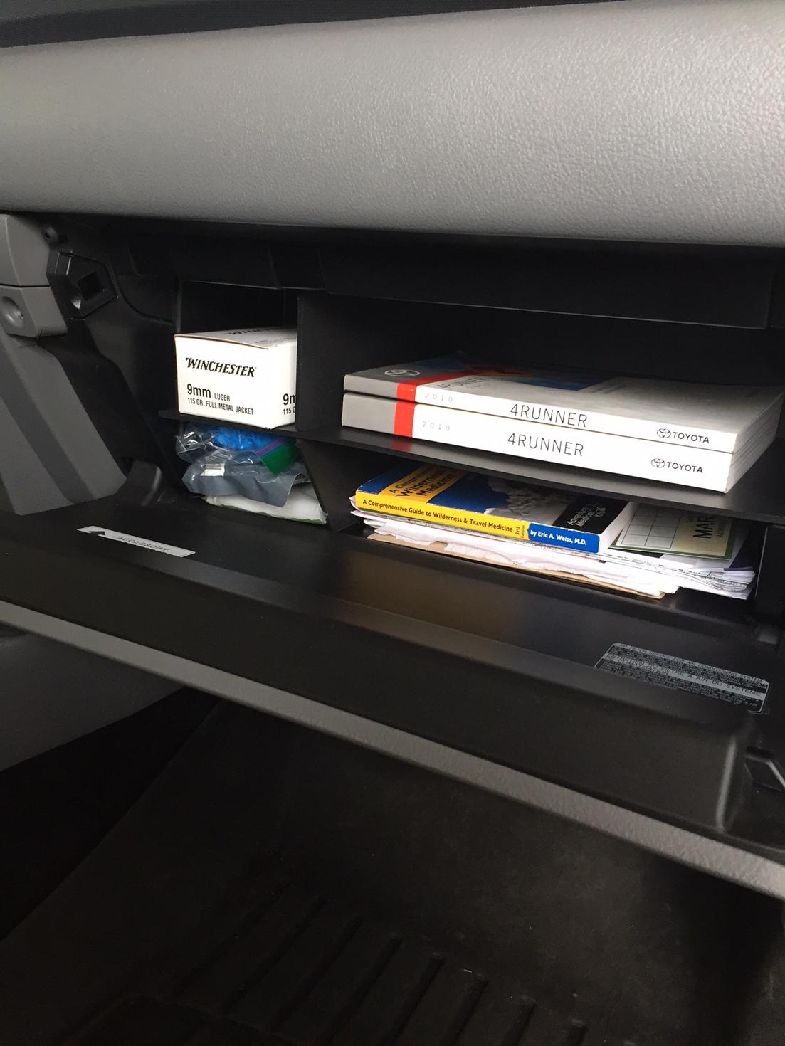

Noticed the other day that after I removed two dividers to store manual, horizontal piece was bowing (not that this is a structural problem, but more my OCD). Decided to cut dividers for added support and regain lower compartments.

I noticed the bowing too in their product pictures on Amazon and that was the reason I did not buy it. Looks like you have found a good workaround as most of us need that large space for our manuals.
Nice customization! Not sure what you used to cut the plastic, but I recommend any power saw with a wood blade. Dremmels tend to melt more than they cut.

I used a table saw for a nice clean cut, followed with a razor knife scrapping edges (not cutting) to clean off burs, then followed by a butane micro torch to slightly heat edges for that final smoothing touch. Lastly, once inserted and lined up, a dab of super glue on the top front thin piece of plastic so it won't move or break.
Although I tweaked original design ever so slightly (I have a problem leaving things alone :naughty:), I'm very happy with the product and would recommend to anyone!
