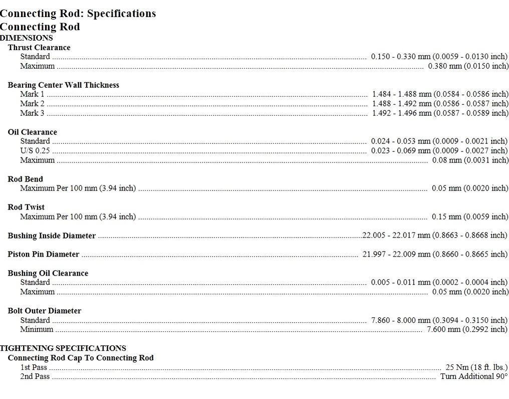

I will look and see if I can find the length but remember you also need to match Piston Pin size and crank size as well as rod thickness. What motor are you looking at for the new rods to come from?
here is what came up
The Nissan VQ35DE it has the same pin end size of 22 mm and the same crank size of 2.165 inches. The VQ35DE is a 3.5l v6 it is 120cc bigger then the 5vz the boar is 95.5mm and the stroke is 81.4mm The 5vz has a boar of 93.5mm and a stroke of 82mm that is damn close. That engine can be found in the following.
