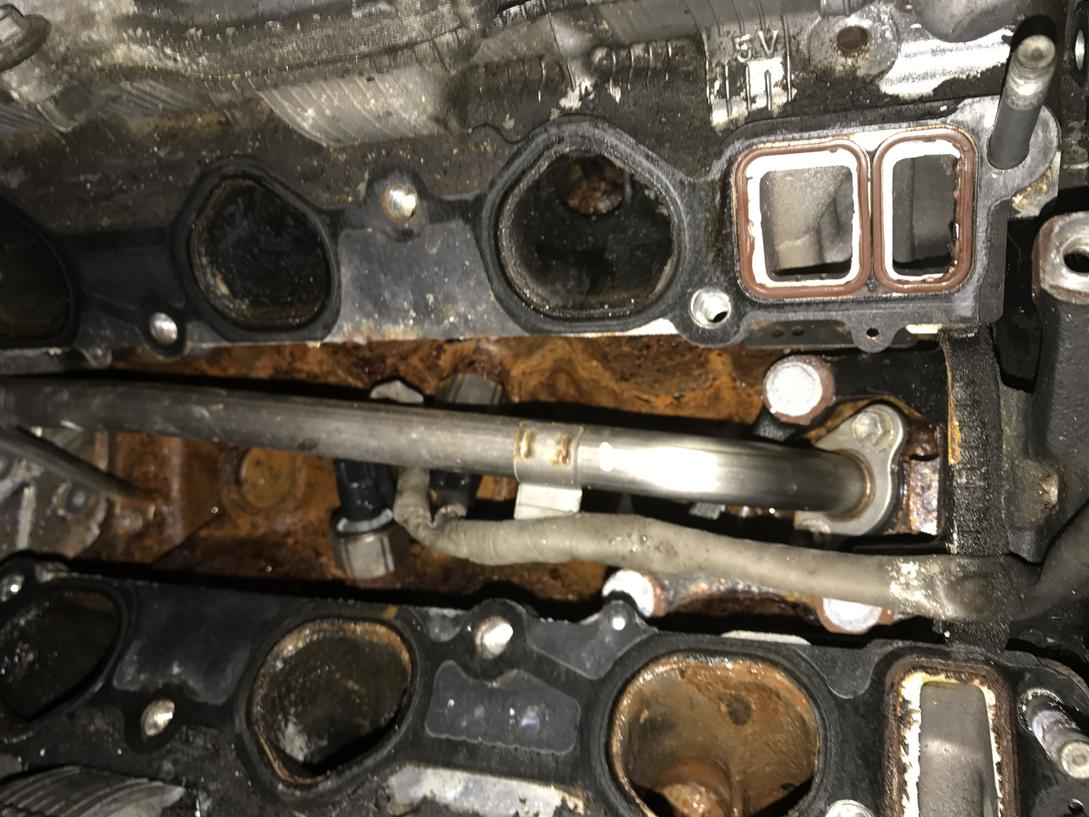

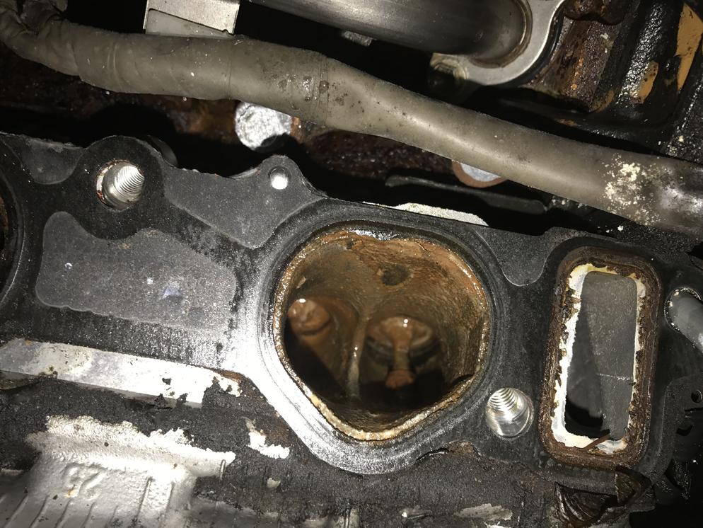

Ordered an engine from jdmenginedepot through their eBay store. The engine they shipped me was full of water in the valley under the intake manifold, and the valves are very rusty. I'm asking for a full refund and plan to buy a different engine from jdmenginezone from their eBay store.

what can i say, some people get good engine and some dont. I personally would never buy a used engine over internet. I would only go and look in person and then make the decision

Again, his engine is from Engine Depot, not Engine Zone.
Shady ass employees at JDM Engine Depot. Every engine I saw looked beat to shit.

I understand. It's not where I got mine from. But just I'd personally never buy a used engine of the internet

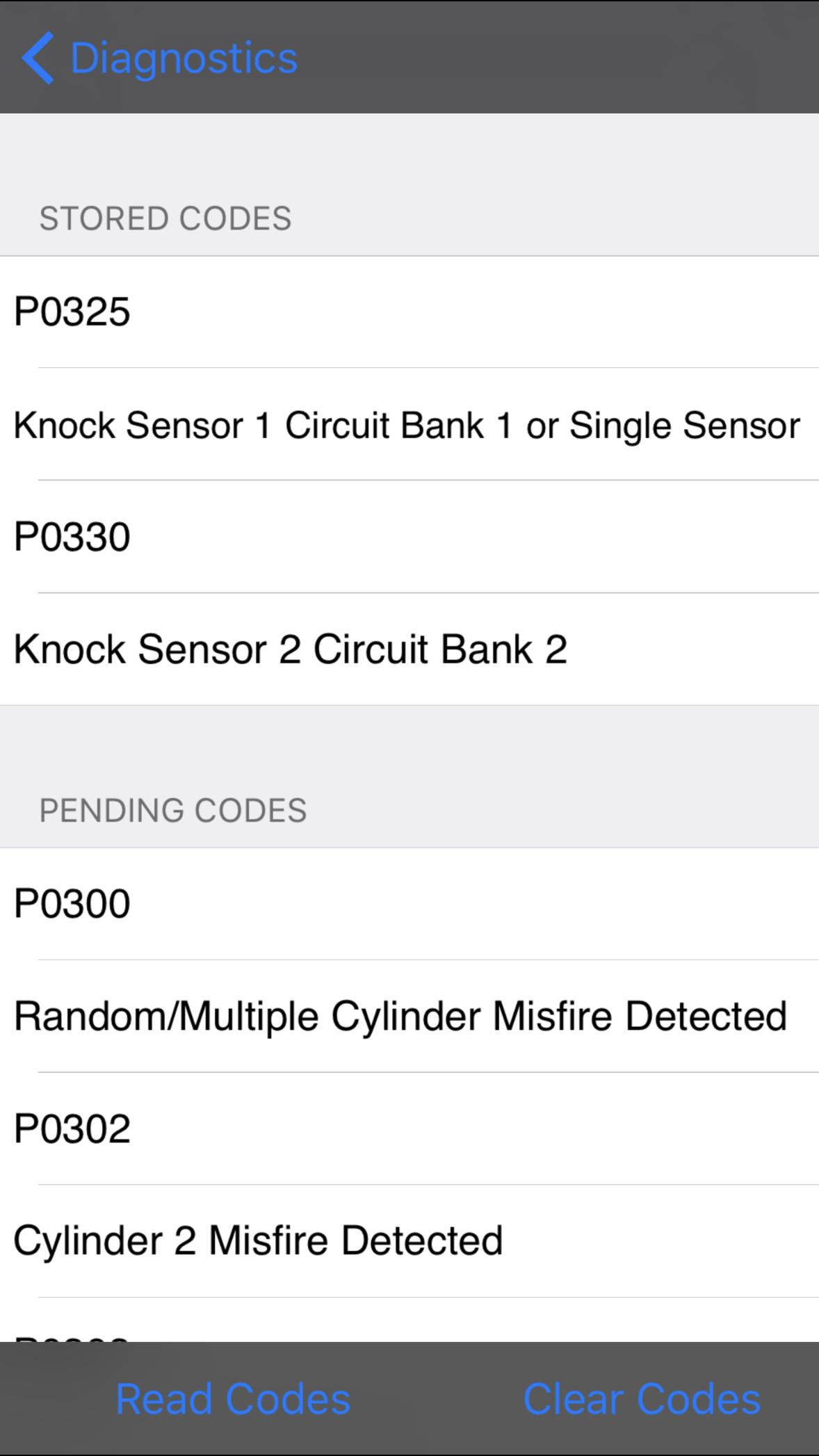

I got my new, new engine installed and running it smoked quite a bit at first but less once I let it run for a while. I took it for a spin around the block and got a misfire code for every cylinder other than #1. Also got these. Does anyone have any insight on what the issue could be? IMG_0546.jpg

Check/clean harness connections associated with the knock sensors and ignition. With all them codes, does it sound like its run really rough?

Yes it's really rough at low idle. Better at high idle. Lots of white smoke, i'm thinking i may have neglected to plug the knock sensor in:crybaby:

So very rough idle...white smoke...are you losing coolant? oil color and smell normal? maybe run a compression test. if it all looks good, then when was the last time the fuel filter was changed? is the fuel good or old?

I haven't changed the fuel filter but was planning to do that. I was leaning towards the cps being bad since the old motor ran fine until I hydrolocked it.
