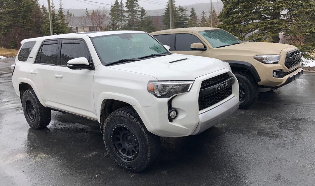

Currently have 5100 all around and fronts set @ 1.75. Planning on adding a C4 and Winch up front and would like to get 2” front lift. Would I be better with new dobinson coils (302) or would 6112 be a better set up?

Both the 5100 and 6112 were designed for stock weight setups, so you might not be happy with either.
Try your current suspension setup after adding the other stuff, then decide if its good enough or not.
Im looking at doing the same - my plan is 6112 (no pro version no height adjustment) with the heavier king spring up front
Seems to be pretty popular
