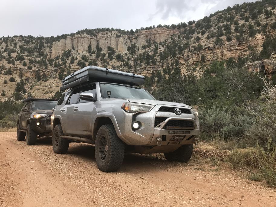

I have all of the added weight that you referenced and did not notice much of a droop when I added my C4 lopro bumper. I have the older 6112’s running on the 4th circlip and have about 2.25” of lift in the front.
If it helps you or anyone else, I have 700lb springs and a 1/2" driver side top plate spacer and recently moved both sides down to the second clip for a softer ride. Bumper is 130+lbs. Feels great, lots of nose dive though but I don't mind. I was at #5 before and it was beginning to feel too harsh. Cant remember what stock height is but I'm at 21.75" hub to fender on driver and 22.25" on passenger with a full tank of gas.
