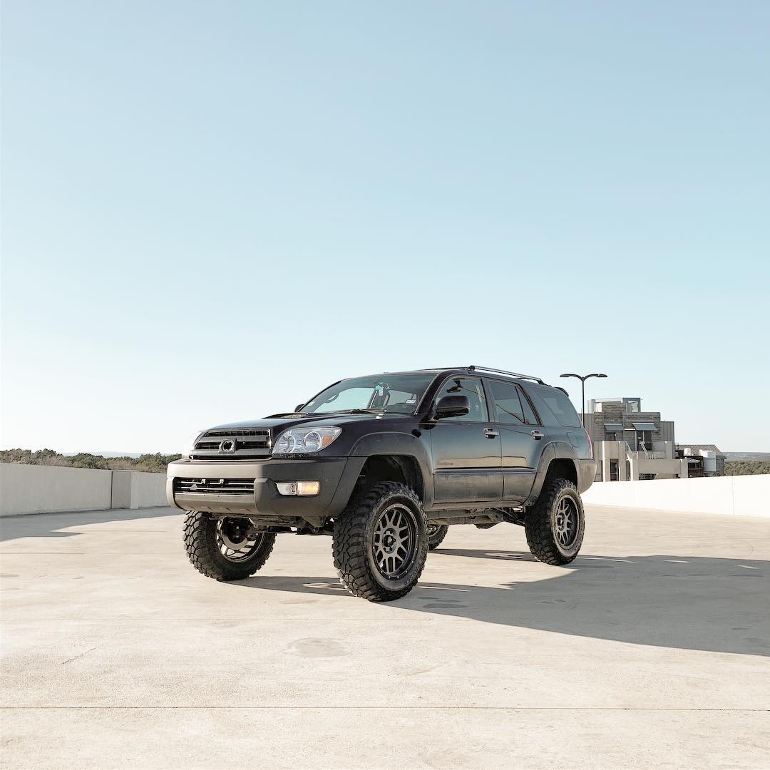

I've been working on lifting my '03 V8 2WD. The rear seems to be kinda limited as far as "kits". Right now I'm using 5th gen 2" springs with a 1.5" spacer in the rear. From what I've read on here, the standard rear height is 21" hub center to bottom of the fender. Right now the truck sits at 25.75", so that's 4.75" of lift. I'm getting some rubbing at full lock and before I start trimming, I'm going to adjust the front Bilsteins a little higher. So I need to even out the rear, waiting on a set of 5th gen 3" springs and use a 3" spacer, so that'll be 7.25" lift out back. I have adjustable rear upper control arms, extended brake lines, and adjustable panhard bar.
My main focus is with the driveshaft angle and possibly length. The u-joints are failing (higher mileage, pinion angle might need some more adjusting), so the truck is parked until I figure out what I need. Rather than replace the u-joints and have them fail again, should I look for a longer driveshaft as well? Is there a common driveshaft swap? With the truck being 2WD, I'm not building this as an ultimate offroader, it's strictly a pavement pounder.. I just want everything to be fully functional

You're definitely going to need a longer driveshaft to compensate for this amount of lift. Jeep guys do this a lot. Common vendor is Tom Woods. They may be able to help of point you in the right direction.

Probably a cost factor when these companies put out these kits. Their product may be at the cusp of not needing it and people that do are a case-by-case basis.
If it were me I'd be investigating a new shaft. The spacer may be OK, especially with a street only cruiser, but still doesn't leave me warm & fuzzy.
I don't see why a new driveshaft is necessary. People have metaltech LT kits in the rear and jump their trucks. Certainly longer isn't necessary IMO but higher angle joints maybe. Then again the driveshaft is already pretty long to begin with, I imagine longer than some of the short jeeps. A driveshaft can be lengthened pretty cheaply, but a full new driveshaft will certainly be a good chunk of change.

I guess the cheapest route is that spacer I linked, as long as it's safe and I don't feel vibration. The highest kit i've seen is 6", and it's a big coil spacer, new shocks, bump stops, panhard bar, upper control arms. I have all that stuff covered, can't imagine another inch would cause the driveshaft to fail. I'm worried about the angle though, the u-joints were fine until it was lifted. I tried my best to get it correct, but maybe it's still off.

The spacer will do nothing for the driveshaft angle, in fact it will make it worse.
