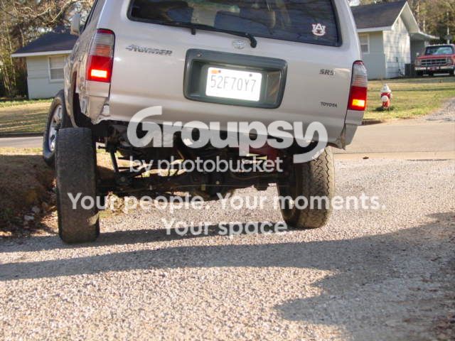

It works for me and you don't need a double carden drive shaft. The lower links are almost in the exact same as the stock axle. The uppers are turned at a different angle and the coil perches are spaced wider. It just depends on how much work you want to do. It' a damn good axle though.
DSC02822.jpg~original
yeah but you have an lc tcase.
