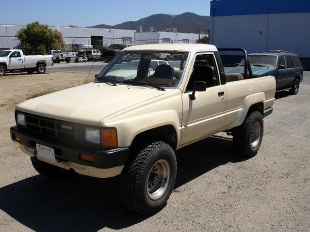

Well Ive been lurking and learning A LOT from this community since I got my truck about 2 years ago. Bought the truck for a good deal (in my part of the country anyway) and have been slooooowly putting effort into her (her name is Betsy haha). Started with a pretty solid platform when i bought it, all stock minus back seats, 165k on the clock, tires i drove home on were made in 87!
If most haven't figured out from my name , truck is a 1985, dlx model, 22re, manual.

Pic of the day after I brought her home

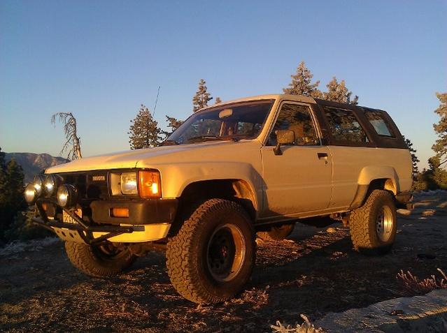

Few months ago

Looks like you're on your way! I like it so far. Question though, the bar on the front was there when you bought it looks like. Do you know where I can get one of those? I am looking to put some sort of lights on the front but I really don't like the look of the just bar bumbers.
Thanks for the compliment! The lights in the first pic were mounted on a tube bumper that came with the truck, maybe hard to tell from that angle
