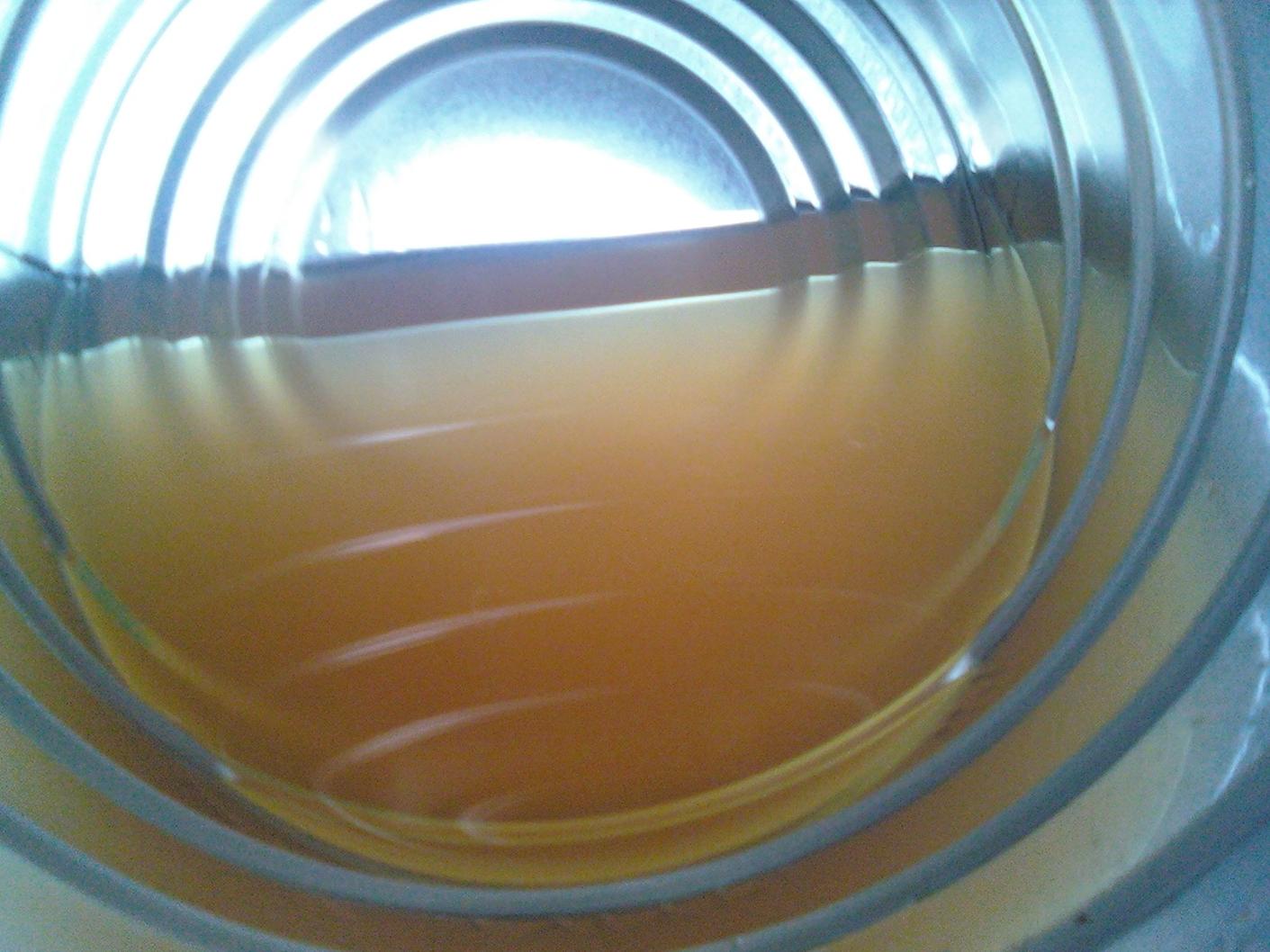

Always think it will never happen to you....the top thin layer is gas, the rest is water and debris.

just my usual routine, nothing out of the ordinary. I get gas at a few different stations, I usually lean towards one because they have no ethanol in their fuel... I didn't this last time. I am guessing I filled up just after the filling truck left the station...When the truck hooks up and the fuel is poured into the tank in the ground it stirs up what liquid and debris is left in the bottom. Some may or may not know, but water is heavier than gasoline. When condensation occurs, water is formed inside the tank and sinks to the bottom, when you fill up just after the filling station truck has replenished the tanks in the ground you have a good chance of getting dirty fuel as well as water contamination because of the activity of pouring into the tank. Gasoline with/up to 10% ethanol has a higher chance of pumping water because ethanol is like brake fluid, in a sense that it absorbs water. This is also why gasoline with ethanol doesn't have as long a shelf life, because it will absorb water(about two weeks and I throw it out or burn it) and of course....cause problems. For what ever reason(women, work, etc.) it slipped my mind. I thought about it being the cause when I removed the fuel pump, but looking straight down into the fuel tank(perpendicular to the liquid)it is hard to notice seperation. I found my fuel gauges today and performed a fuel pressure test, when releasing the pressure from the gauge I noticed dirty fuel spray out. I questioned this because the day before I ran the fuel pump with the fuel rail open at the regulator end to blow out any debris and move some fuel through it and in the first 1/2 cup or so the dirty colored fuel became clear and clean, so I "assumed" it was just some **** in the 280,000mile fuel rail blowing out. Well it became a pattern to focus on when I saw it flow out of the fuel gauge while releasing pressure... hence the reason for the coffee can and the picture! :keyboard: So with the fuel system drained now, I will replace the filter and strainer again and fill er' up. The next post should be happy trucks and owners.
Yes, always to look over everything. remember the older vehicle's had a service interval of 15k miles for fuel filter changes.... but that was 15 ott years ago! gotta go with the times and realize the fuel we have now-a-days is different(ethanol) and the gas stations that were built 15-20 years ago are starting to show age in their equipment... they may look new above ground but below ground they may be skimping on maintenance costs or replacement of 20 year old tanks.... hence the reminder of fuel system inspection.... happy motoring all
