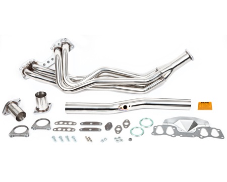

I came across these Trail-Gear stainless steel headers. Priced right inbetween the LC and DT...

You're right, there's not a huge gain in hp/torque with just a header, but a good combination of header, exhaust size, and if you're able to get away with it, the removal of the cat, you can see a good amount of gain in power over stock. What the exact hp/torque numbers are, I have no idea as I've never thought of dyno'ing my truck before and after! I will say that given the low, stock hp numbers (what's stock? Something like 110hp, right?), going up by another 15hp does indeed make a big difference in how the truck runs.
And I agree, just saying it "makes more torque" is just a generalization, but if anyone's interested in how a tri-Y header works vs. a 4 into 1, there's a ton of articles on them all over the place, some are very technical and show actual data in their tests. From what I understand, the tri-y scavenges better in certain rpm ranges than a 4 into 1 would in that area, but the 4 into 1 does better at higher rpms because they supposedly flow more freely.
I have had both and will still make the claim that the tri-y works better with my 22RE than the 4 into 1 I sold many years ago. I've played around with my other friends who have 22RE trucks/4 runners, and aside from one of them, I could literally walk away from them while going uphill in 4th gear! I do have a lot more done to my engine than most people too, so as I said, its a combination of things I've done.
One other interesting thing I have noticed is the amount of power lost with a cat! I'm not encouraging anyone to go out and pull their cat off, but for me, I've run without one and IMMEDIATELY notice a difference in how it pulls away! I have also noticed that when I had the cat out, I gained almost 2mpg on a long road trip than when I had it in on the same trip. I've since found a hi-flow cat that seems to work okay, although it still doesn't have as much seat of the pants pull as without running one!
