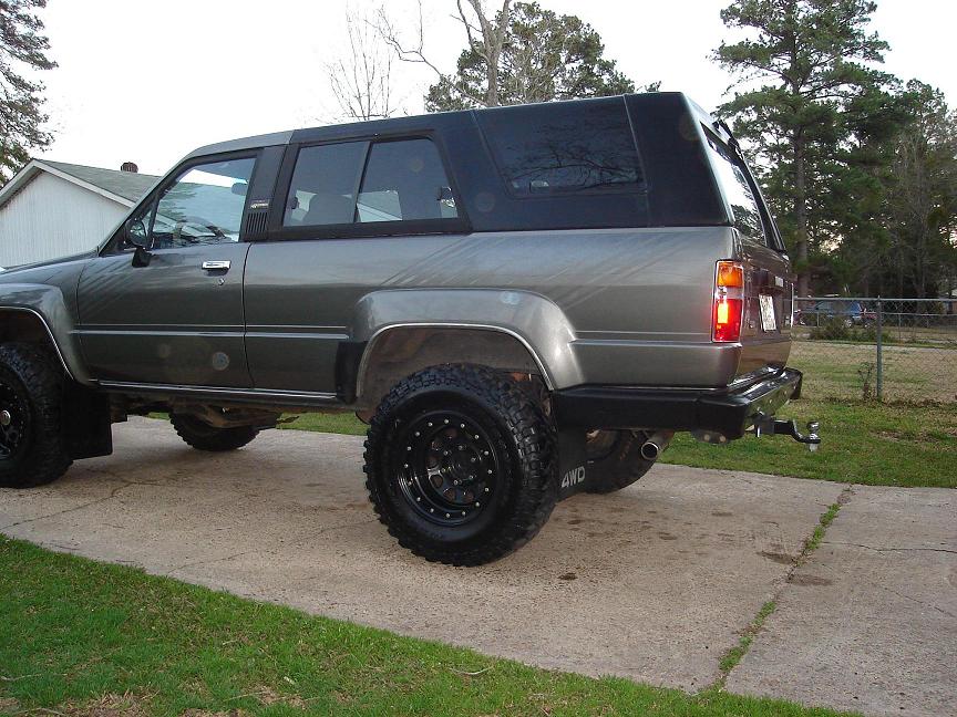

Judging from your avitar, I think you might have some trouble in the rear with 10.50x31-15 tires. You might not but it looks a bit saggy. I'm sure you could get away with 9.50x30-15.
Put an OME lift kit underneath and you won't have any trouble with 31" or 33" tires (although for 33" you might loose a lot of power unless you regear).

OME lift has worked very well. Let me know if you want any info on where to buy, what's entailed, etc.
Hey Bama share the secret... I just want to really keep my runner as is, not going into any lifts just wanna fix the sag.

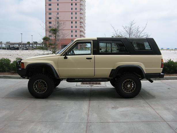

It is fairly widely understood that you can run 33x10.50 with no rubbing, (BFG's may be your only option for this size)
I run 34x9.50 with only the slightest rubbing on the pinch weld, so I flattened it.
