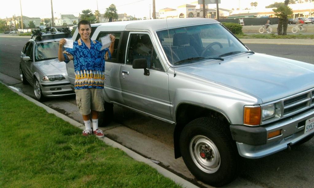

What's up guys? So I have a first generation 4runner(88 4x4 4cyl 5spd). Just got some $$$ and have been driving it for a good while and ready to get started on the work. I'm between buying a new suspension sytem(even I it's just shocks.) don't do much off-roadin, just little things here and there; mainly a daily driver. That, if not headers. The rig feels like it's in the Sahara when driving down the road. Want to know if anyone knows whether gas or air shocks would be best? Looked at some blistiens 5125 on yotamasters.com and don't seem bad. HELP!!!!!

Are you looking to fix the rear sag (which looks like your truck has).

IF indeed your truck has the rear sag, fixing it would help make the ride comfortable because truck will regain some spring action. (With sag, truck rests on the overload springs that are stiff.)
After fixing the sag, replacement shocks will still be necessary if your existing ones are shot.
