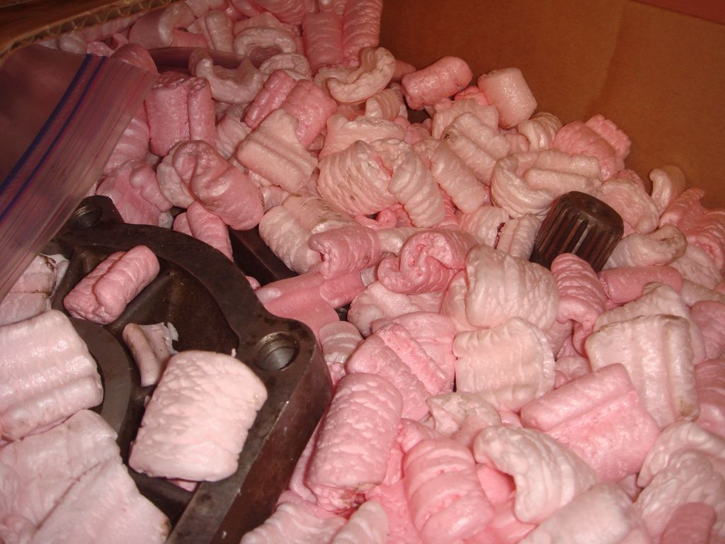

Well I couldn't bring myself to cut another runner up so I am recycling old faith full which was very capable

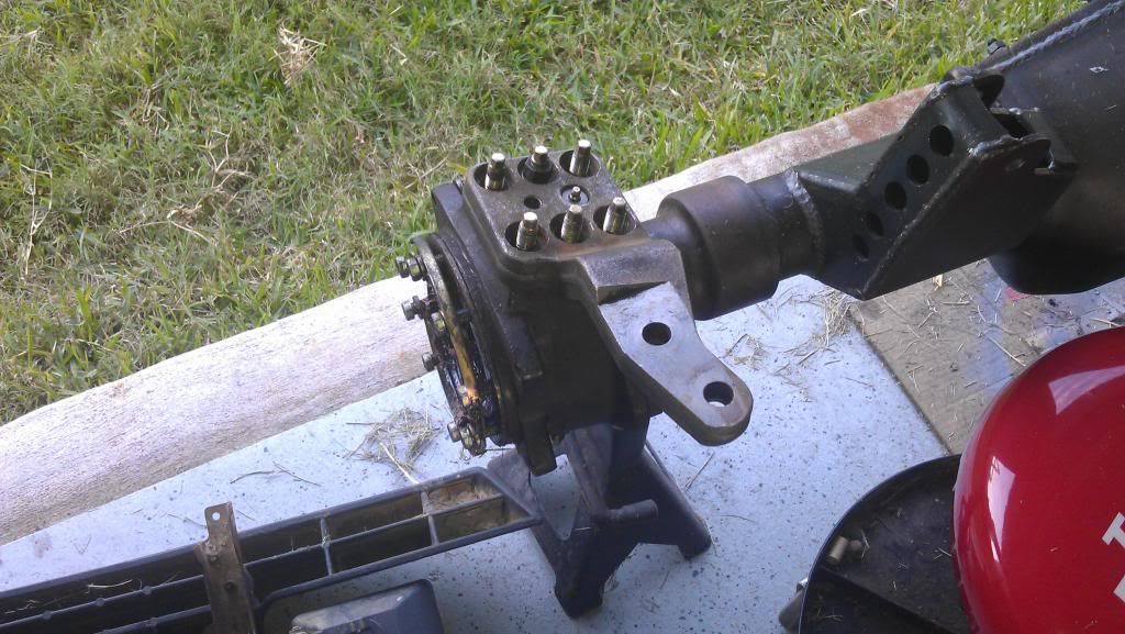

TG 61" front housing
6 shooters w/trunion elim kit
hysteer using D44 steering setup and hydro assist
8.4 taco rear
Hp 5.29 ARB front
8.4 Detroit rear

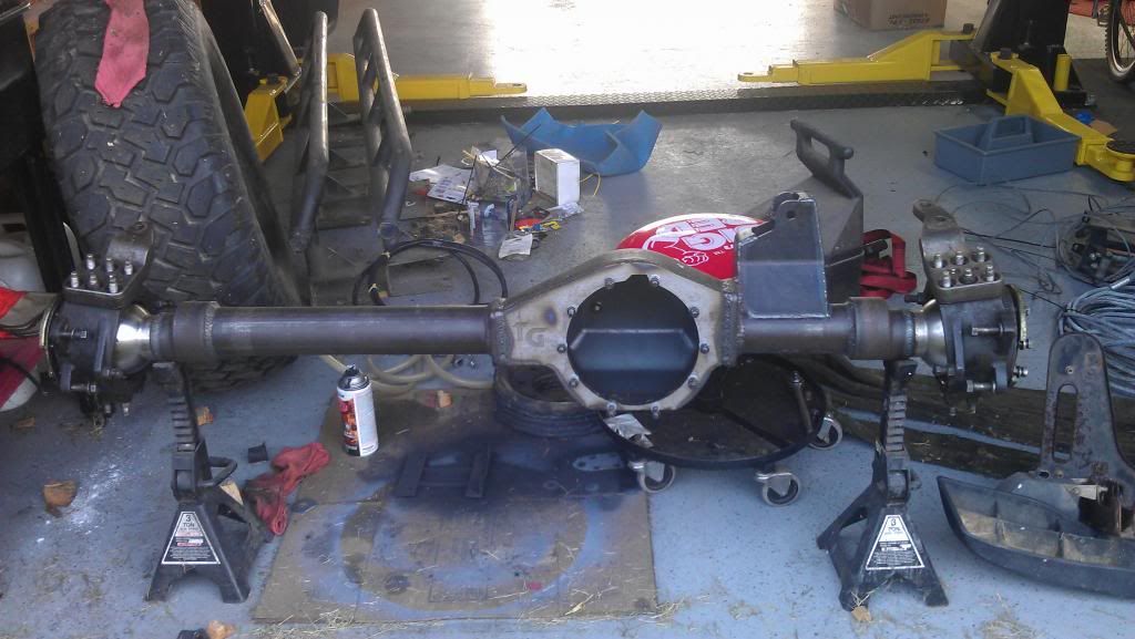

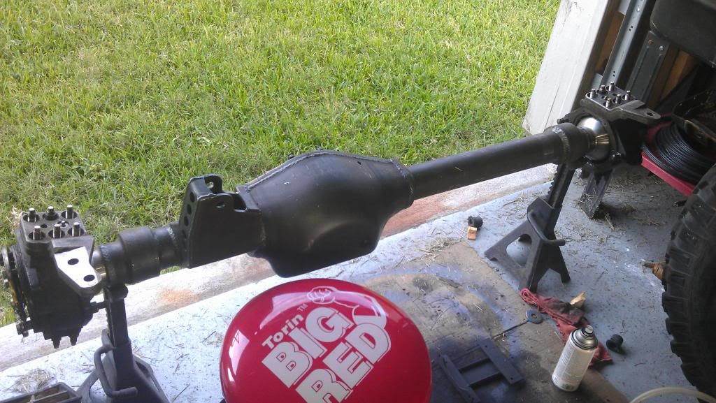

front axle 61 3/4 TG, six shooters with ARP studs and trunion eliminator kit installed. Plan is to use T100 calipers(have had awesome results with them in past)
next I plan to install diff and tack link mounts to axle, then make it a complete roller so I can fine tune placement. My goal is to move it enough to not have to trim fenders or floor but not look goofy hanging out the front. We shall see !

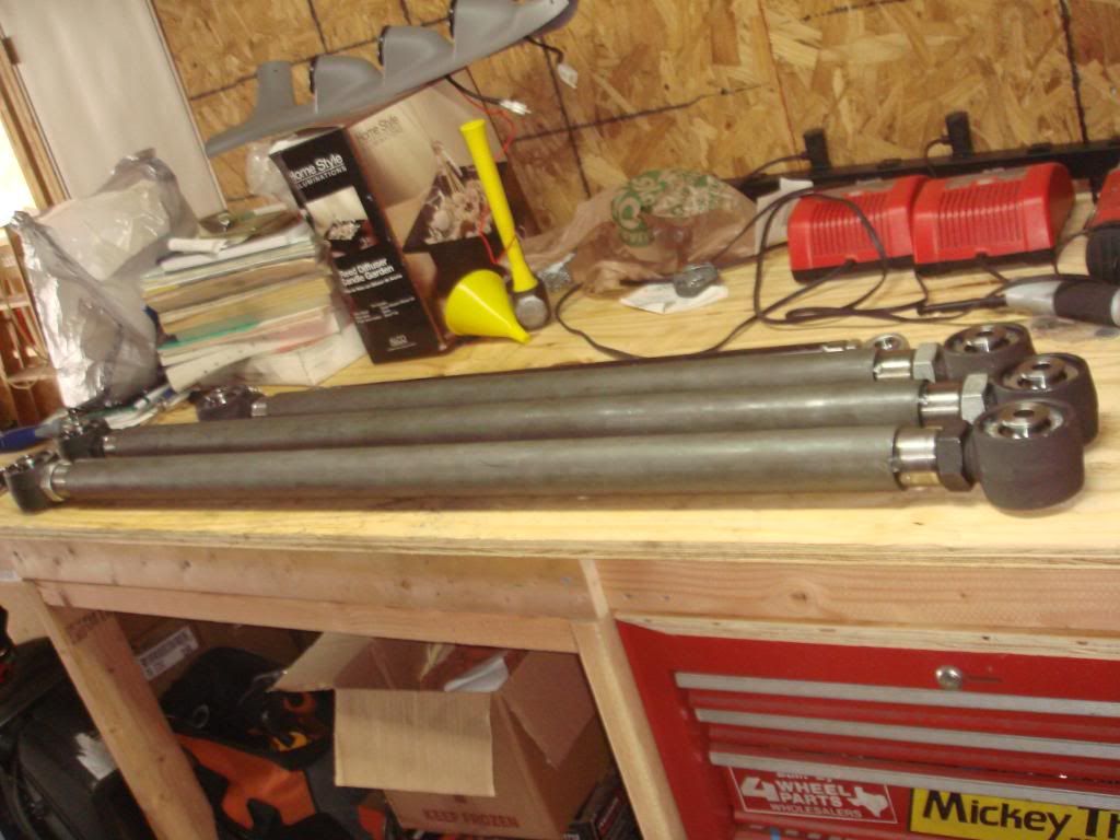

links tacked together, going to practice my tig skills before I finish them up.

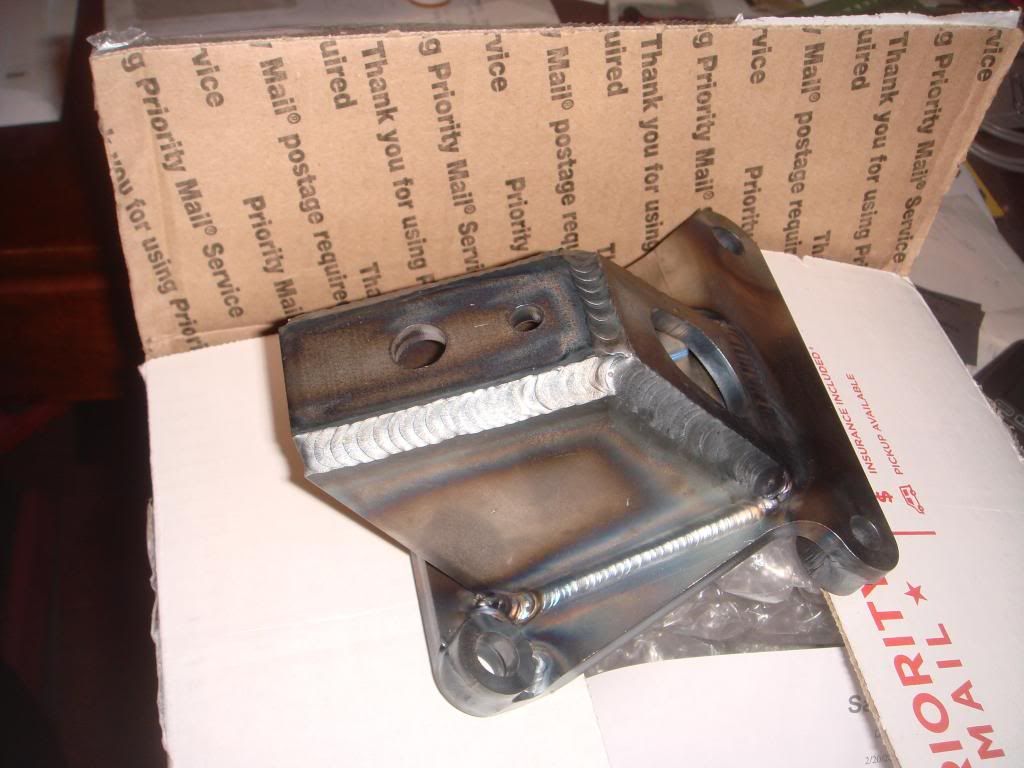

new chilkat motor mounts, love there craftsmanship !!!! Whish I had there skills !!!
now to decide what color to powder coat them, thinking red ?

I like this build too. I wish Chilkat mounts had been in my budget, those are gorgeous.

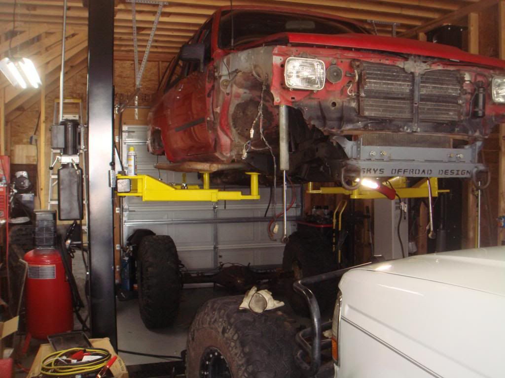

finally getting this build off the back burner, it's making it's way to the shop this month. The donor rig is all ready to be gutted, we just gutted an 00 donor runner for customer project.
