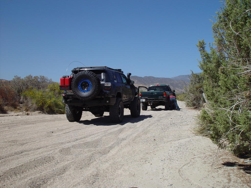

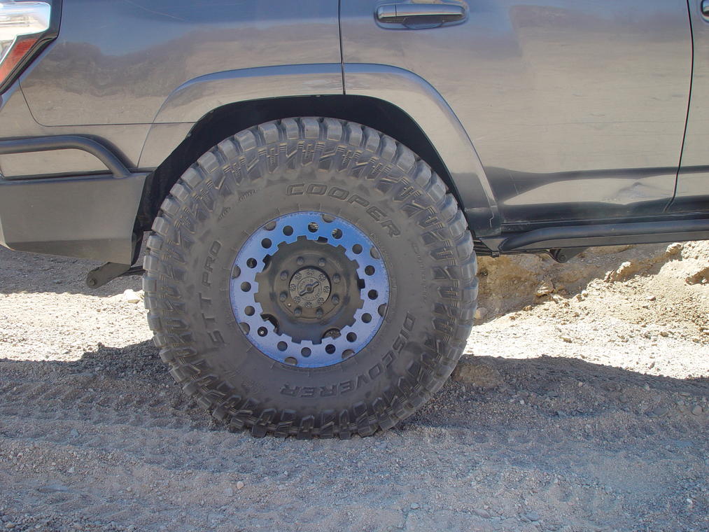

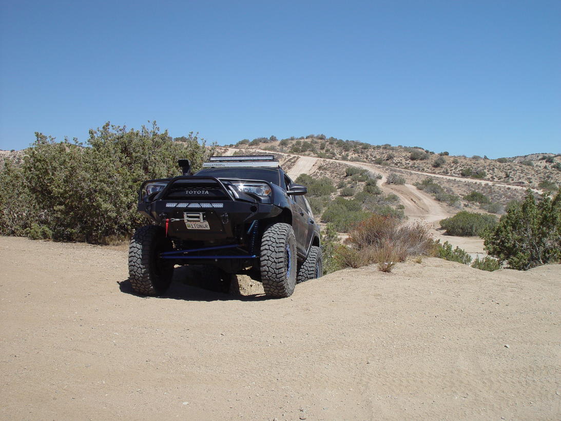

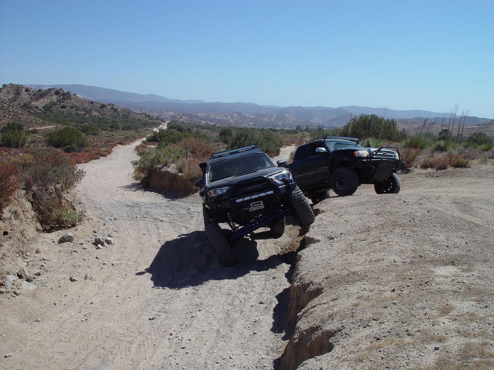

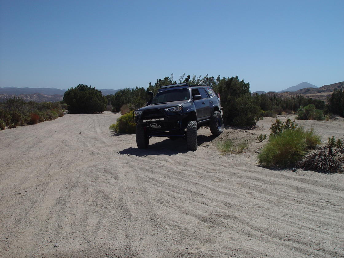

So I have been lurking in the shadows on this website for a little over 10 years now, prior to my current 4runner I didn't really get to modify my 4runners much. My newest 4runner however has become quite the project, I have been meaning to create a build thread for some time but haven't gotten around to it until now. Heres some pictures to start this off and Ill reserve some posts for future mods and trips.
