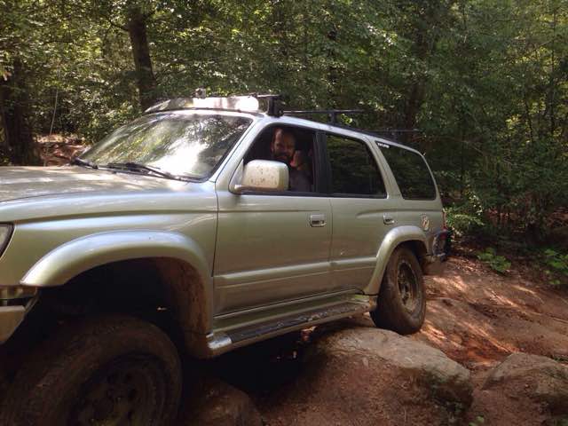

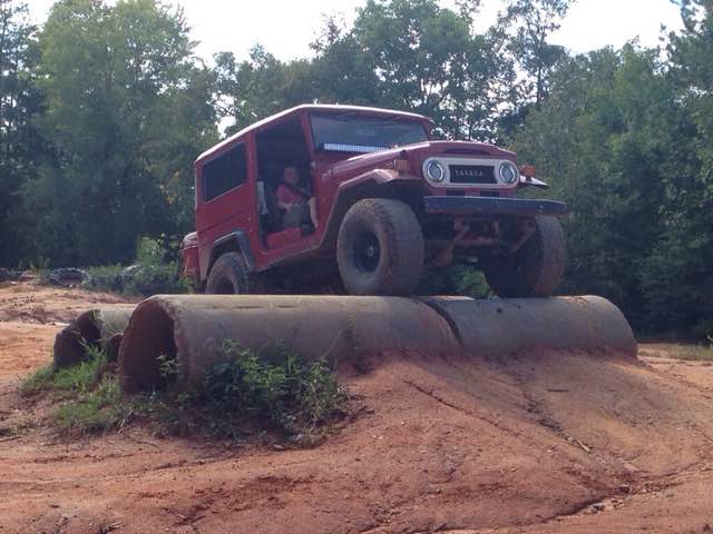

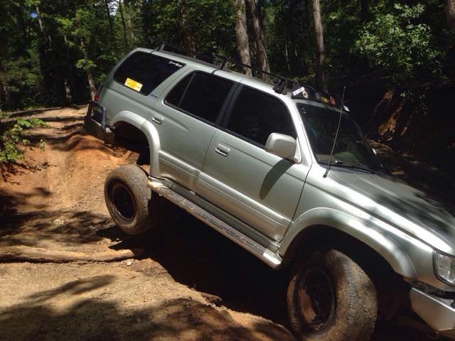

Made it over to Gulches with a friend of mine. Had the most fun on 56? Made me miss my km2s these 32" Cooper ATs were ok but we're a little short on a few things.
He's got a nice 40 on 35's
Gulches is about 30 min from my house. Might end up over there more often sure beats driving 3hrs+ each way to wheel.
