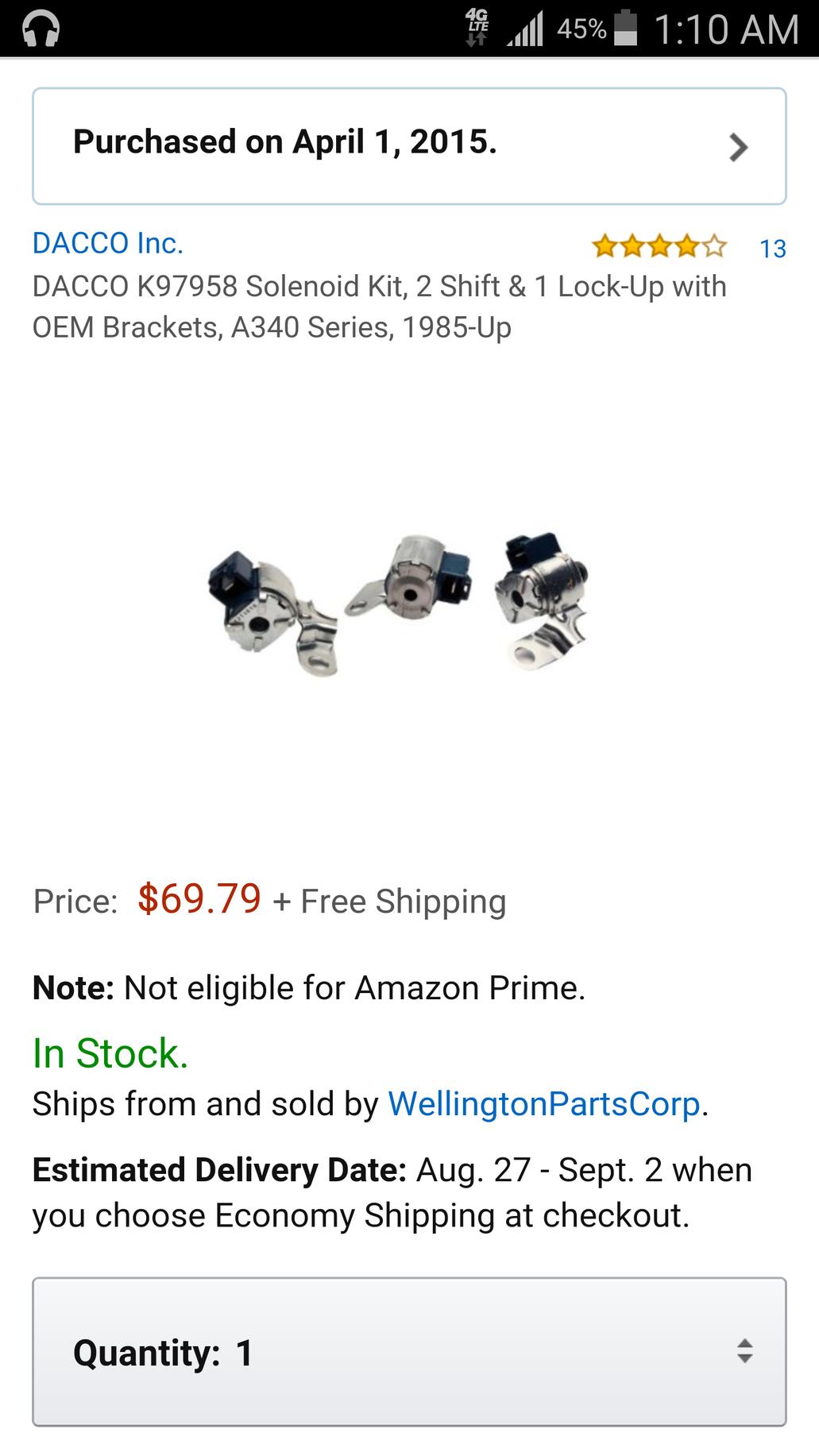

I have very similar issues. Replaced the 3 solenoids today, and no help. Had the same issues in previous gen 2 and that solved them. (BTW got all 3 for like $70 from a place in Houston, can find link if you want). From fsm no lock up can be due to everything from bad tps to coolant not being >178° so bad temp sensor? Or a handful of other things. I'm too exhausted from today's failure to think about it more tonight, but I'll check in tomorrow.

Damn that's rough, I feel your disappointed feeling. Throwing that link toward me would help me quite a bit.

Got the solenoids from amazon, ship from Houston. More than $100 cheaper than if you order straight from Wellington.

Hell yeah brother thanks for the link! :whoo:
