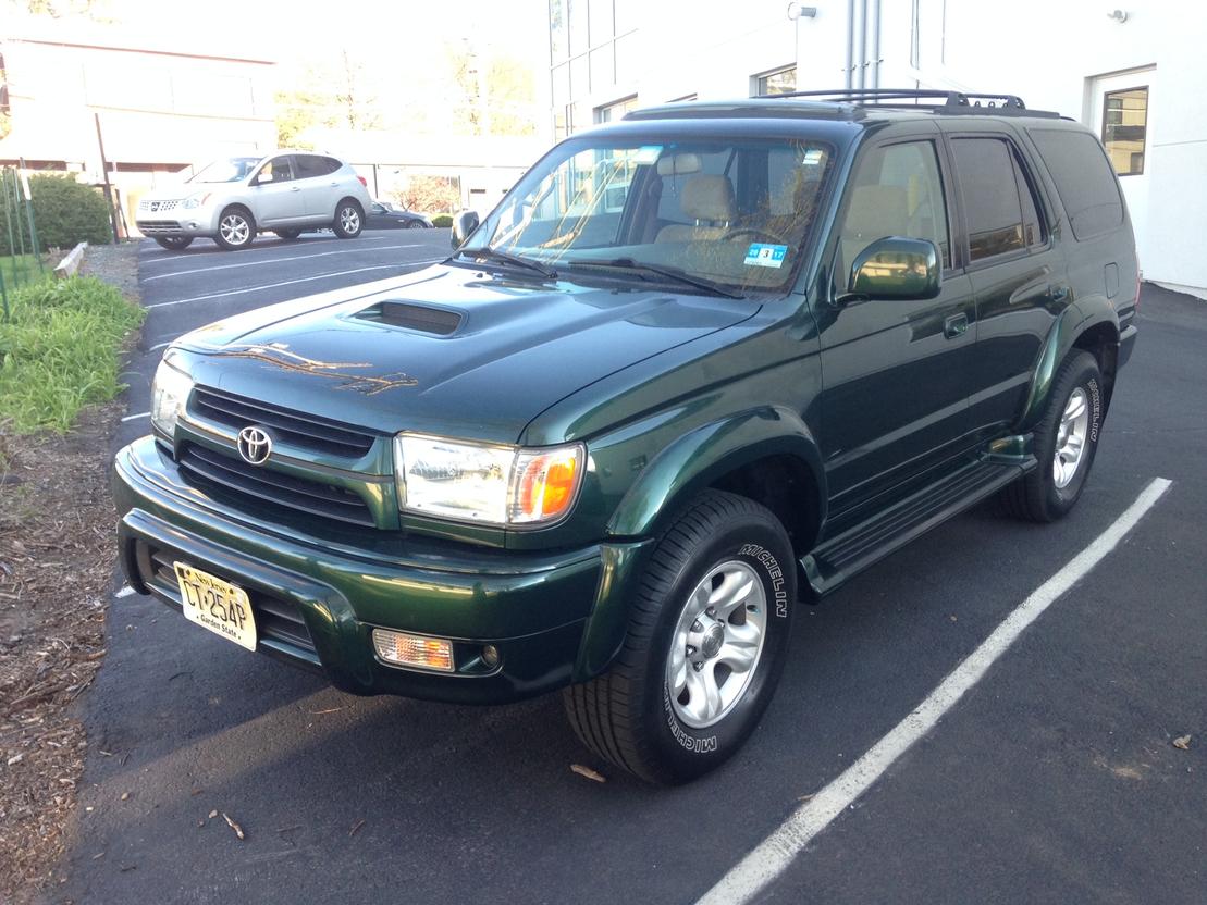

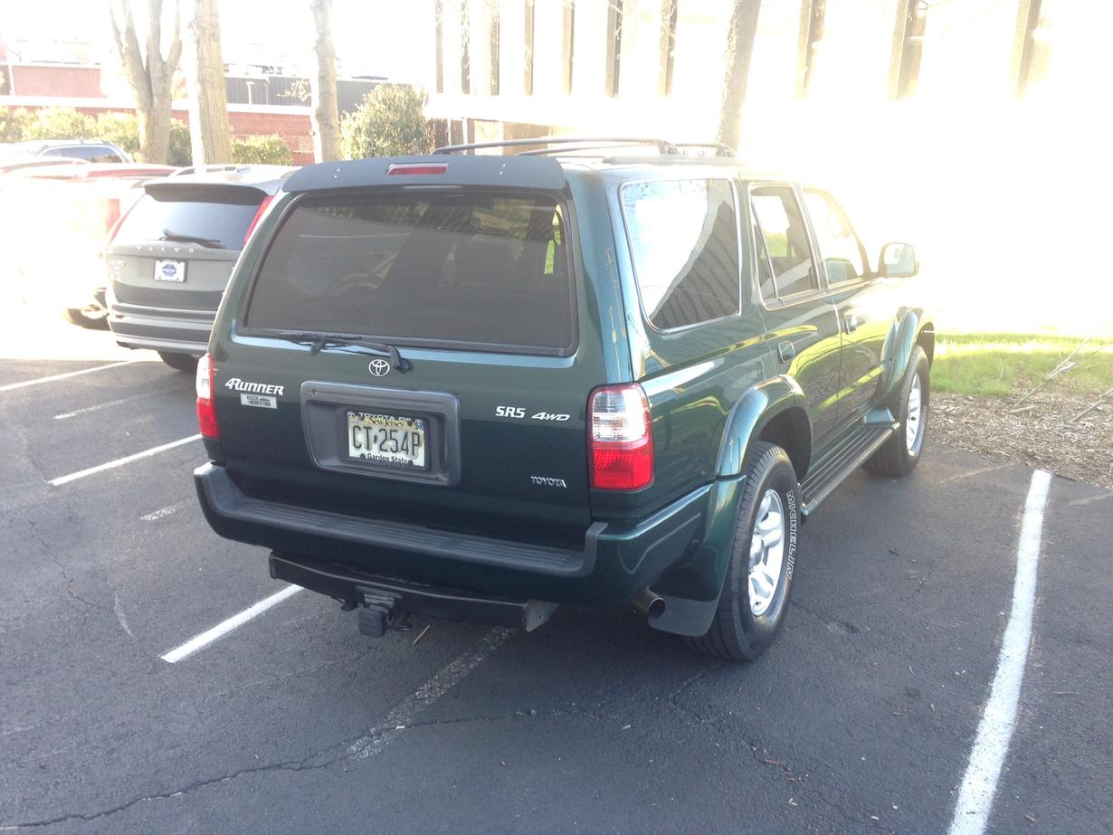

These days I haven't had a cool ride in quite sometime so when I took this 2001 4Runner SR5 Sport in on trade 2 months ago with only 88k on it I had to jump all over it(if you knew how cheap I got it for you probably wouldn't believe me). This is how she looked the first day I saw the truck:
The vehicle was one-owner and garage kept all it's life. I was actively looking for something to tow my 16' aluminum boat and for hunting so this fit the bill perfectly. I won't be dd'ing it as I have a demo for work so this will only be driven maybe once or twice a week. The truck is in pristine shape and already had the t-belt done. The original owner already had a double din head-unit installed with streaming bluetooth, gps and an ipod charging cable so for now the stereo is everything I need. He also had a cold air intake with heat shield installed as well. When I bought the truck I had 0 intentions of modding it and planned to keep it stock. LOL like that ever happens...
