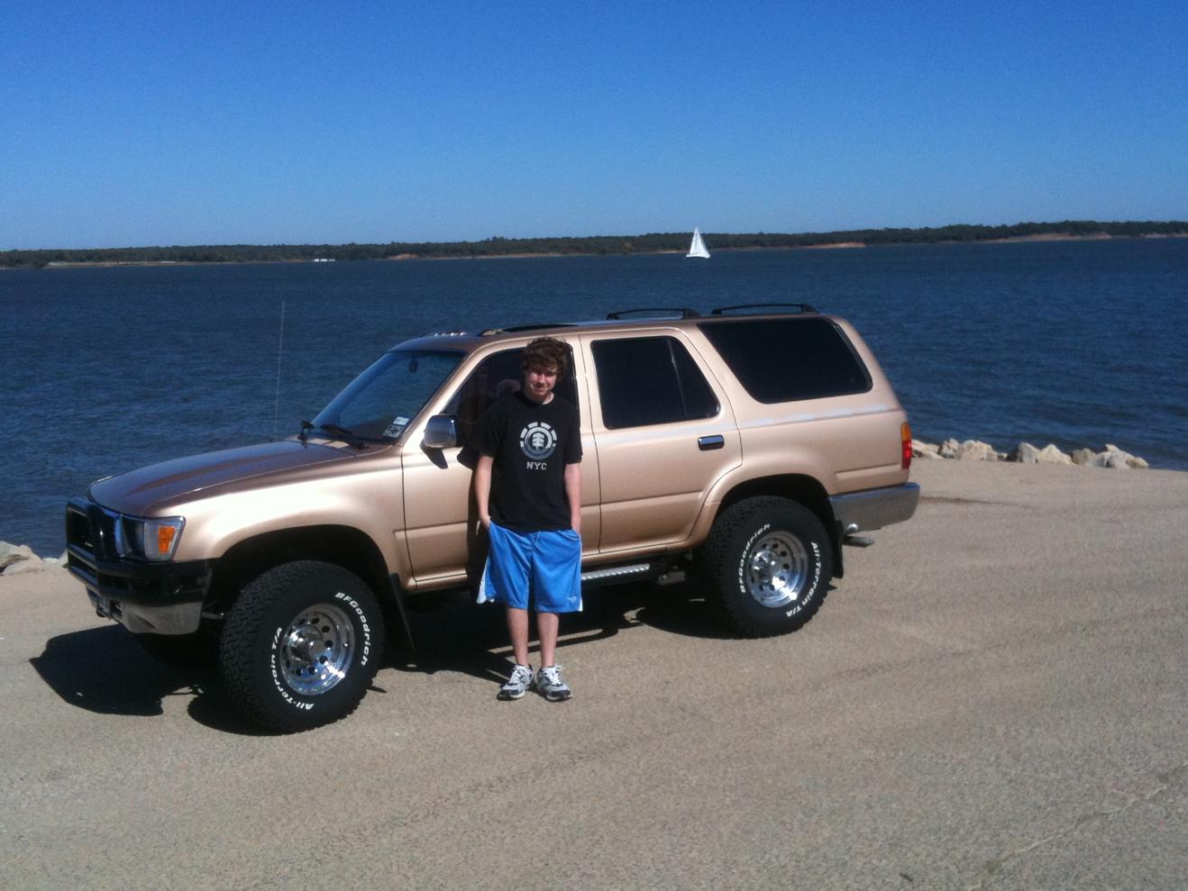

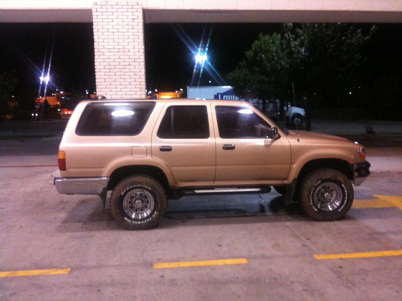

Go to Oreilly auto parts and buy the MOOG replacement springs. Those springs brought my sag from 33" in the rear and 35 in the front to 36" all the way around from ground to the fender. I gained 3" in the rear and evened the entire vehicle.
see pictures, first one with my son is with the sag, second one is the day I replaced the springs, no sag. The springs were less then 90 bucks and were easy as heck to install.
