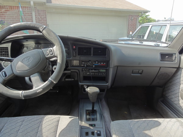

Hey guys, I have this problem with my runner (115k miles). It's been like this ever since I bought it back in September of last year. I have to use a screwdriver and move the ignition switch separately from the ignition cylinder just to start it (yes, it is embarrassing). As much as I love it, I have to sell it to get something a little more fuel efficient seeing that I'm a high school senior without a job, it would really help the sell if I could fix this problem. Okay, so heres the dilemma: I put my car key into the ignition and turn it but it won't budge. It acts as if I'm using the wrong key, although I know I'm not because it turns a little bit and locks in the key but doesn't go into acc mode. Which is unfortunate because it has to be in acc mode to remove the ignition cylinder. And I am pushing in the retaining pin while trying to pull out the key. Also, I am a big DIY guy so I will refuse to take it into a shop. Anybody out there willing to share some knowledge? I'd appreciate it.

Not sure if it would be so simple, but is your key damaged at all? Have you tried turning it with your spare keys? I'd try that and if it doesn't work, you may want to look into getting a new lock cylinder. Maybe it got damaged or is seizing up.
Yeah, I went out and got a new key as a spare and tried that, but both of the keys are perfectly fine and aren't bent. I'm trying to get the old key cylinder out so I can put a new one in. And the only way to get the old key cylinder out is by turning the key to acc mode and pushing in a retaining pin while pulling out the key along with the cylinder. But seeing that I can't turn the key at all, I can't replace the key cylinder. Any ideas? thanks.
Well, I lubed it up with graphite. Didn't do anything. Key is still getting stuck turning it to acc mode. Anyone have any tips?
