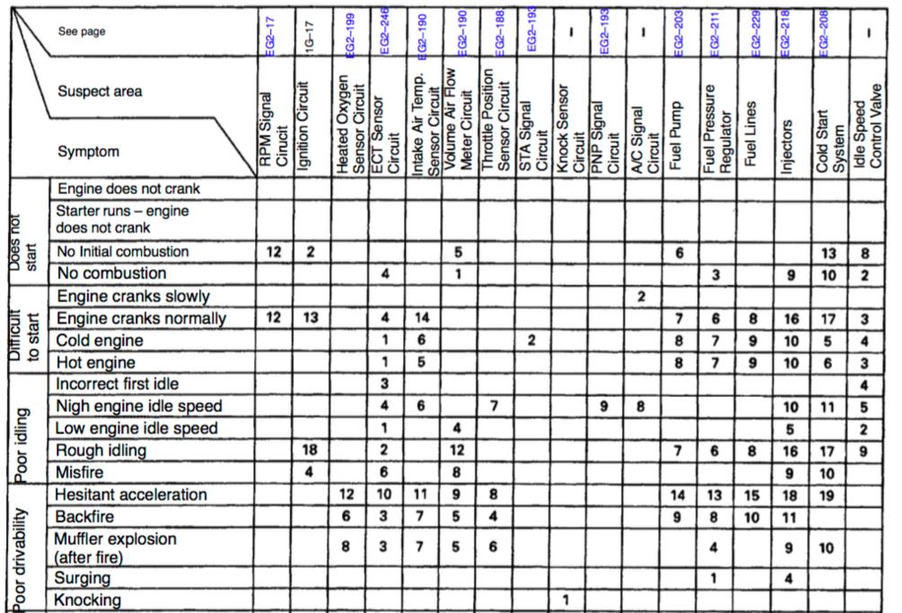

From the troubleshooting guide, it looks like throttle position and volume air flow meter are the computerized things to look at, while fuel delivery could also be a culprit. Since you're running rich, it's unlikely the pump is giving too much fuel, rather you're probably not getting enough air, causing the hesitation and poor idle.
