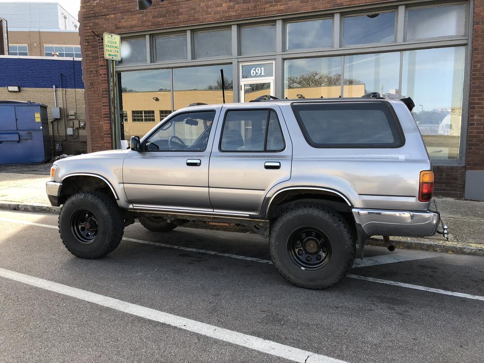

It’s about that time I actually intoduce my first 4runner I’ve owned. Back on Christmas Day of ‘17 I pulled the trigger on a ‘95 SR5 4runner. However this one is a bit different, what started life as a 3.0l auto 4x4, this one was swapped this a 3.4l. I was told it came out a ‘97 with only 5k miles... still not sure about all that. The auto was ditched for a 2nd gen manual trans. The truck was “lifted” with old fJ coils and the torsion bars cranked the the moon... here are a few pics of what she looked like when I got her.

Looks great! Nice to have that 3.4 done and out of the way - and the rear LC upgrade is another great thing to have done! Now just to sort out that overly stiff front end! Looking forward to seeing the progress on this one. Welcome to the 2nd gen crew!
