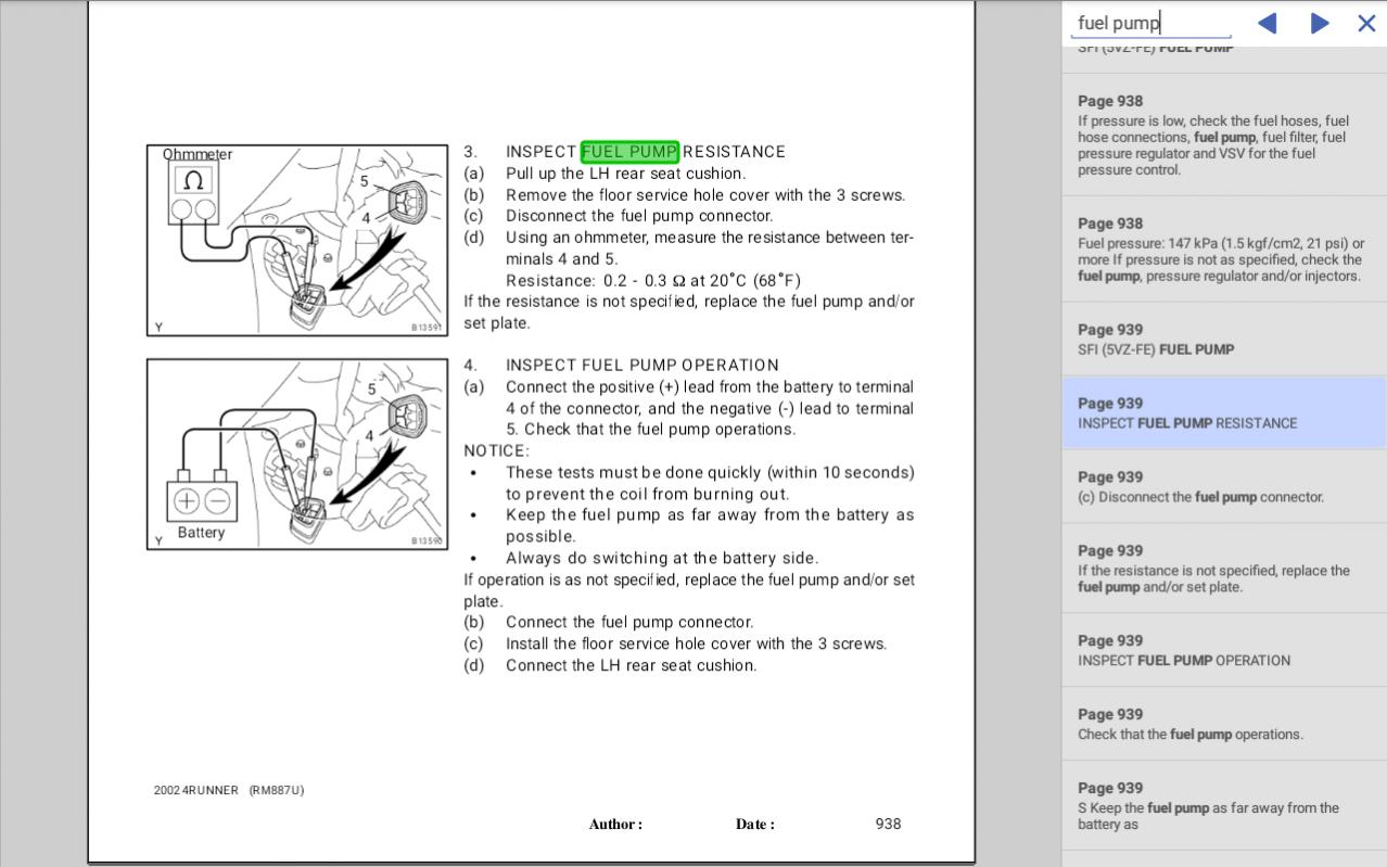

test the fuel pump.
Fuel pumps are a rare failure but it sure does sound like it. Test as posted above and go from there.

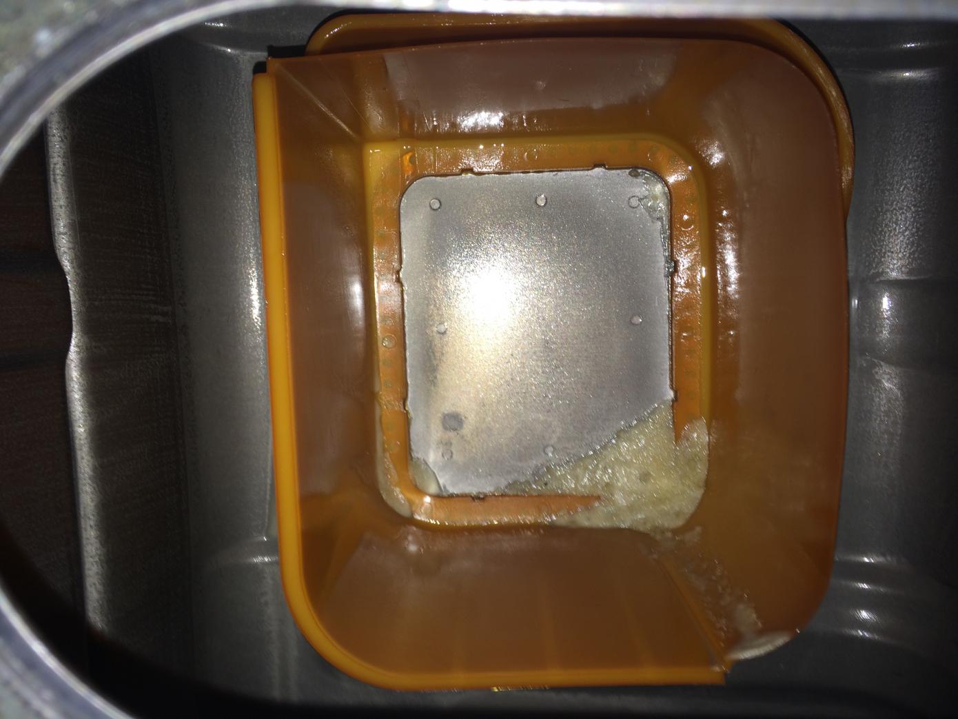

I know its been a while but thank you all for your replies! I have been busy and finally got to dig into this thing. anyways I was thinking fuel rather than ignition just because it does it depending on how much fuel I have in the tank. the lower the level the more frequently it does it and at lower rpms. I tested the pump and resistance was good. I also applied 12v and confirmed that the pump operates. it has never not started on me just takes an extra crank and all my problems occur under load. I have already replaced the fuel filter with a Toyota one that's the first thing I did then plugs and wires. I know this thing sat for a bit with about a quarter tank before I bought it and I thought there might be gunk in there so I dropped the tank today just to check it out and this is what I seen. what is it and how do I get it out?
also someone already replaced the whole sending unit with pump with a spectra premium brand which I was pissed about because I worked at Lordco up here in BC for a while and I sold many of them (only brand we had) and warrantied a good amount. also had quite a few people who came in steaming mad because it crapped out on them shortly after the warranty expired and I felt bad for em. spectra shouldn't even exist their parts are pretty expensive and just the lowest of low quality. I try to steer people away from it now a days cause I work for another company and we have other brands. anyways I am just going clean out the tank somehow and install a new denso pump with a used oem sending unit.

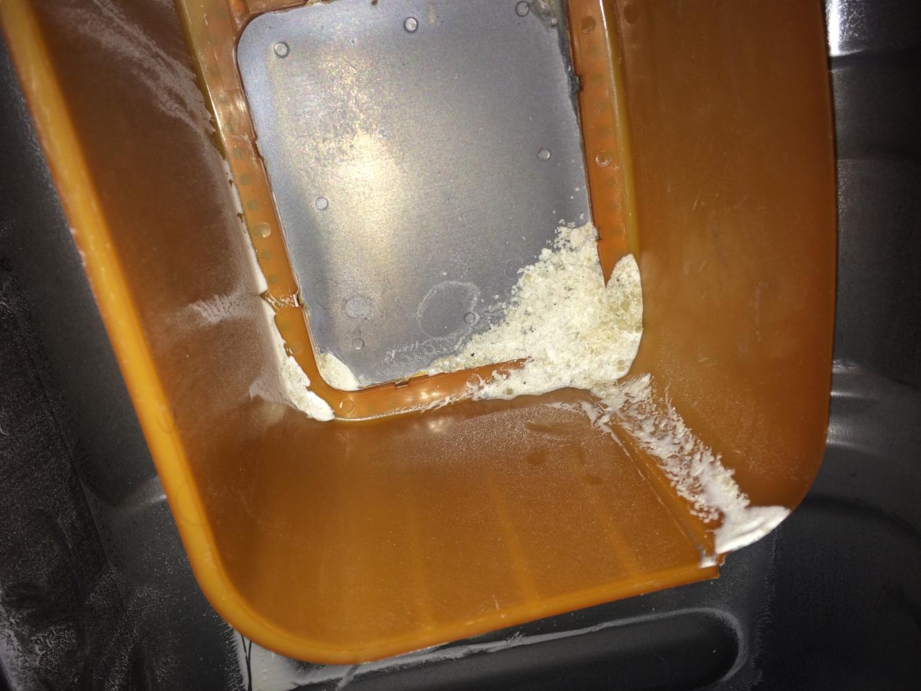

clearly nobody does when it dried up its like chalk and its not just in the bucket its in clumps all over the bottom of the tank i think justtroitin is onto something with the sabotage hahaha
should i soak it with brake clean, seafoam? any ideas?
this worked great good as new now. I read the ingredients and its just sodium and water lol oh well 9 Canadian dollars you get a cloth and rubber gloves too UNREAL!
Sodium and water? I thought mixing sodium and water would cause an explosion and I took chemistry in high school.
