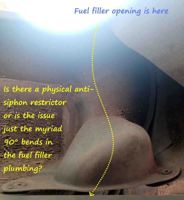

I tried to shove a 1/2-inch vinyl siphon hose into the fuel filler but the hose only goes in only an arm's length and then stops dead.
Obviously there's some kind of restrictor (anti roll ball or anti siphon or whatever).

5. Remove the large-diameter fuel filler hose from the tank (but WHERE is the anti-siphon restrictor located?)

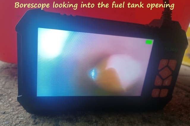

Unfortunately I also wasted a LOT of time with the borescope my friend lent me, but then after an hour of not getting it to show me anything, I started wondering what would happen if there was a tiny spark - and I shut it down - but I never did find any anti-siphon valve that I could identify.

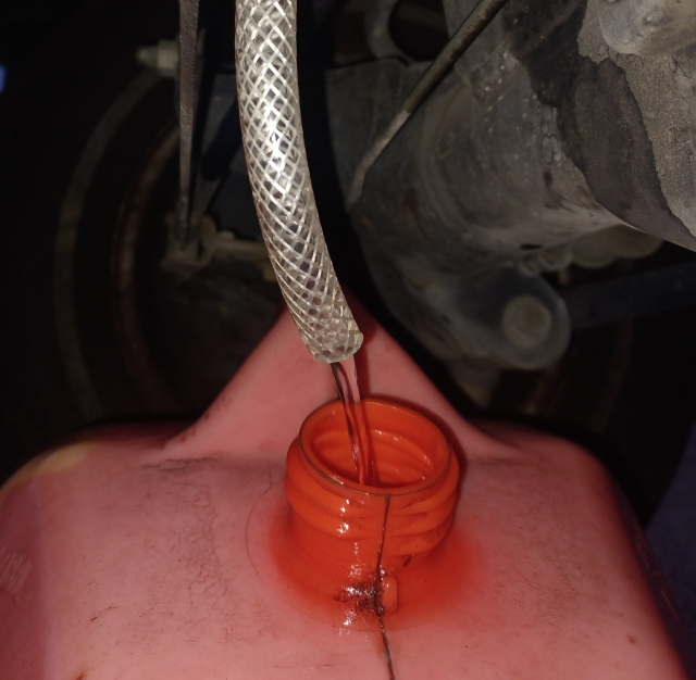

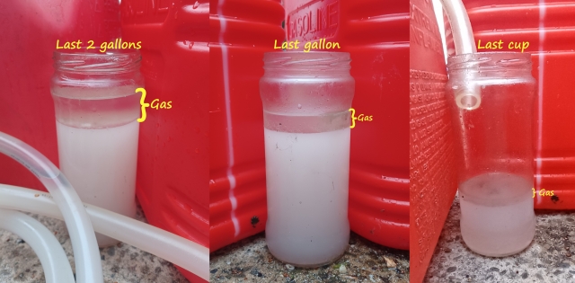

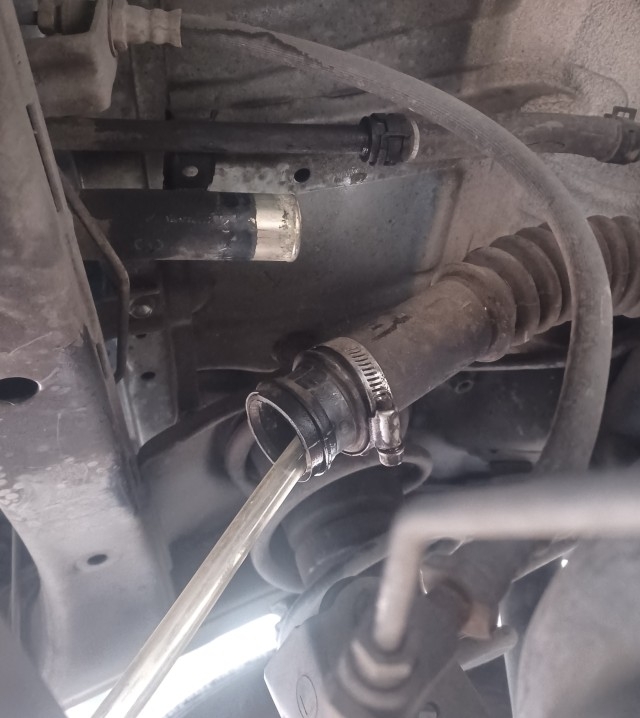

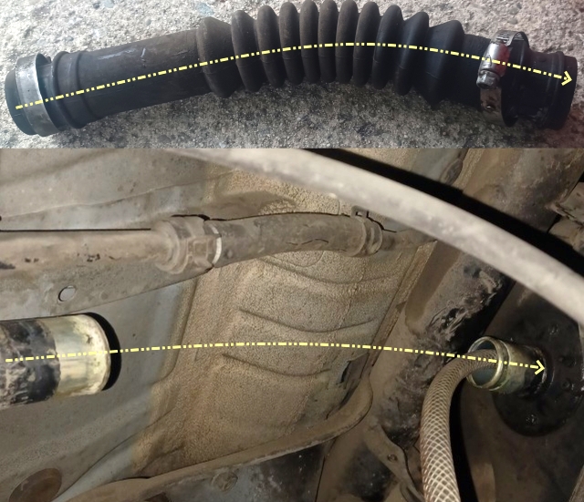

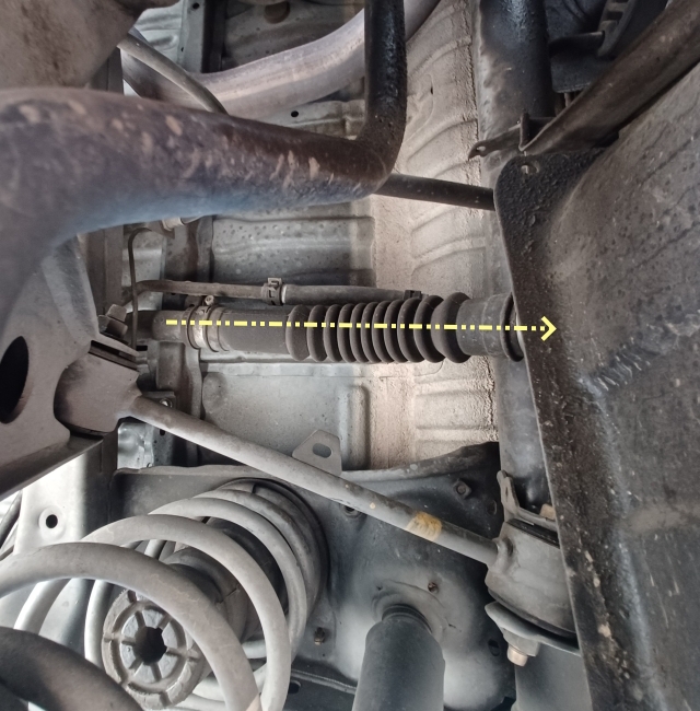

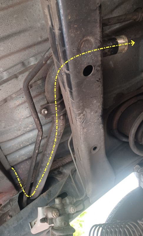

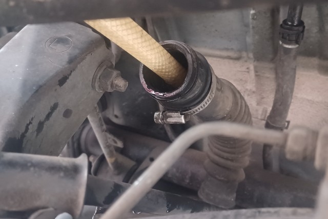

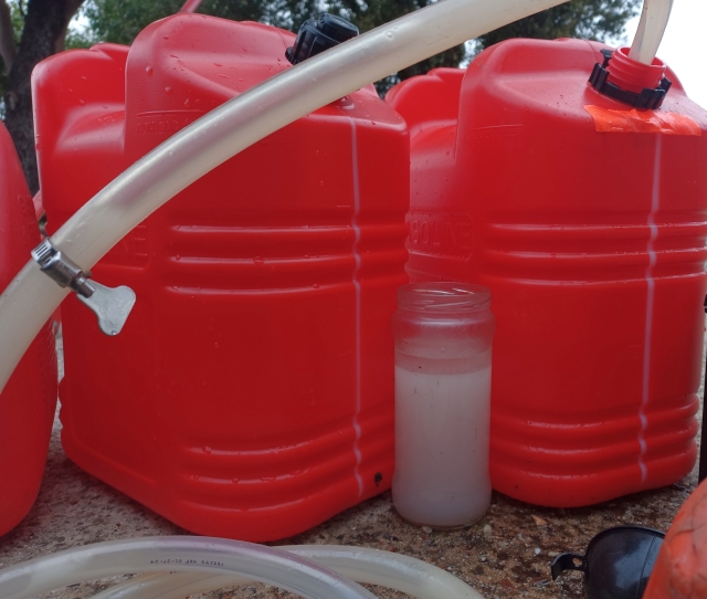

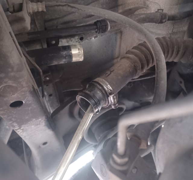

I was able to siphon out just a few ounces over 11 gallons.

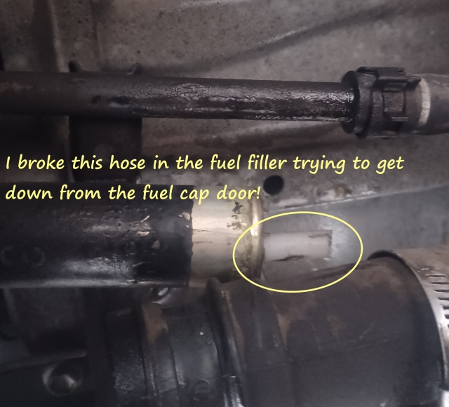

I first tried all sorts of hoses starting from the fuel filler cap door, but they kept getting stuck (if they were flexible) or breaking apart inside the fuel-filler tube (if they were more rigid). This one broke off but I pulled it out later.

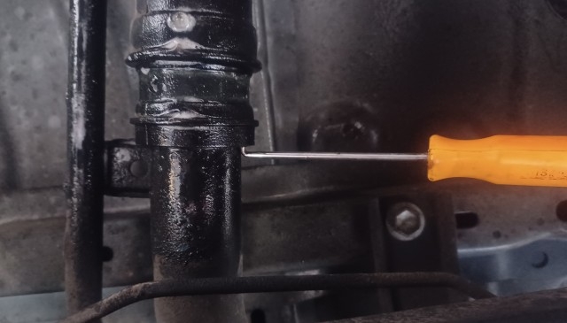

I ended up removing both 10mm/#2Phillips hose clamps ends of the foot-long 1-1/2-inch diameter rubber filler hose which goes into the rump hump of the fuel tank. Then I shoved my 3/8ths inch beer carbonation vinyl hose into the tank as far as it would go, and blew on it until I felt resistance.
Then, lucky me, I mouth siphoned (I'm still burping gas). After a few wet starts, 11 gallons eventually ran out continuously but very slowly. Very very very slowly. Took at least an hour or more just to empty 11 gallons.
Without a DIY, I made a ton of guesses, all of which failed except the final guess. For example, the siphon hose gets stuck if you try to remove only the upper end of the foot-long fuel-filler rubber hose, and you need a stiffer siphon hose than the one in this photo (which failed).
And, if you try to go through the fuel filler door, that hose will break inside the fuel-filler hose - which you'll have to open up to remove the pieces.
I need to thank Tim-The-Toolman for his trick of Harbor Freight angled pick tools to loosen the hose after removing the 10mm hose-clamp bolts.
But I tried removing only the upper end of the hose and that just won't work. The hose gets stuck every time in those creased folds.
I wasted a LOT of time trying to find the optimal hose but no hose would work from the upper end of the fuel filler hose so my recommendation is to go deep the first time instead of wasting time on the wrong end.
At the end I carefully poured the results into gas cans where I stopped at the 5-gallon mark to make sure I measured the 11 gallons right.

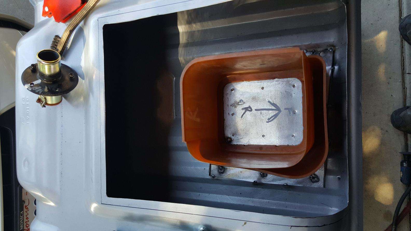

The 3rd gen 4runners have I'd say about 97% metal fuel lines, with the last 3% being from metal lines to engine. Cars now a days have some type of pex/plastic/vinyl tubing that isn't friendly to ethanol with quick disconnects.
There is a baffle/sump where the pump sits where it might be impossible to get the water out due to its shape. I'd put the front up on ramps to make any remaining water go to the back of the tank and then you can get it out from there.
Only other way to get it 100% empty and clean would be to drop the tank and drain and let dry.
This pic is the baffle/sump that's in the stock tank.
Thanks for the picture of the baffle inside the tank around the water pump. It behooves us to all know where all the bends & baffles are, in case the next person who reads this needs to know ahead of time.

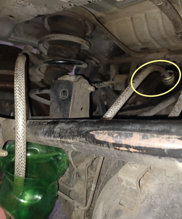

For example, here's a picture of the pipe from the fuel filler door to the rubber hose that connects to the back top rump of the gas tank. I don't see any anti-siphon valves - but - it sure has a couple of very sharp bends, which I think prevents siphoning from the gas cap entry door.

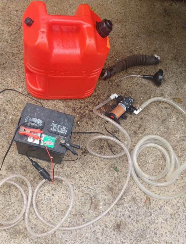

I finally got 13-1/2 gallons of liquid out using the 12VDC fuel pump lent to me by my friend, where each gallon was more water and less gas than the prior gallon was.
I took the advice above to tilt the vehicle from rear high first, and then in the end, front up in the air as far as I could get it. When I jacked up the front as far as I could get it, I got another cup of liquid, so that helped as the last few gallons were almost all water as you can tell from this composite photo.

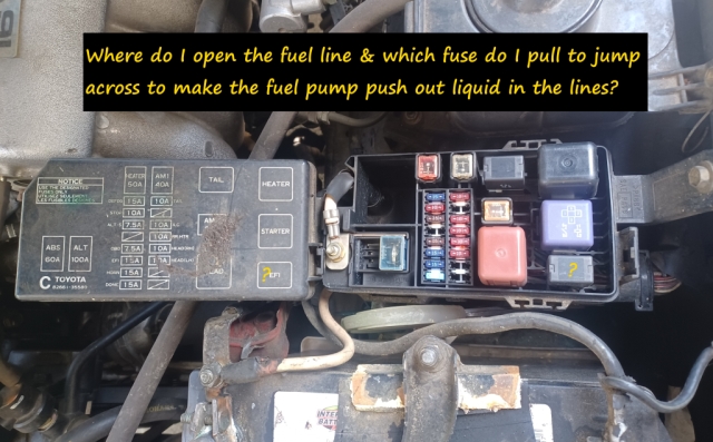

In a few places I saw you remove a fuse and jump across it, but my EFI fuse won't come out.

What I don't know is where to open the lines and how to make the fuel pump work since when I tried to pull the EFI fuse, it wouldn't budge.
The engine has a return-type fuel system. When the fuel pump is on, the fuel lines have a constant flow of fuel from the tank, up to the engine, past all the fuel injectors to the pressure regulator and back to the tank.
Just put in fresh fuel and drive it.
In factory form, the fuel pump only runs when the engine is cranking (key in START position) or the engine is running (circuit opening relay triggered by the ECU when the engine is running).
If you want to power the fuel pump in the key ON, engine OFF position, you need to jumper the circuit opening relay that is bolted/mounted on the bottom of the fuse box in the driver's side lower dash. (early OBD-I Toyota's had a way to do it from the diagnostic connector in the engine bay, but that connection is not there on the 3rd gen 4Runner...) Obviously you can also directly power it with the right wires under the rear driver's side seat bottom too...

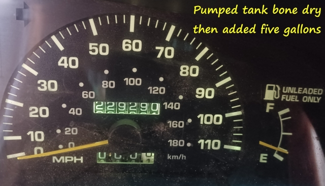

To give an update, that post gave me the confidence today to do exactly what Charlie recommended, even though I did pick up a fuel filter at O'Reilly's this morning to replace the one under the driver's seat area (but the comment about stripping the threads scared me off as it had already been days since the original problem).
I put five gallons of gasoline of Costco into the tank (which, interestingly, brought the fuel gauge level to 1/4 reading for the nominal 18.5 gallon tank).
Then I tried starting it until the battery died. I jumped the battery from a donor vehicle (with that donor vehicle running) and tried again, and again, and again, and again.
Finally the engine sputtered to the point that I could get it to run for a few seconds by vigorously pumping the gas pedal (do they still have accelerator injectors?).
After a few of those very rough starts, the engine started purring beautifully.

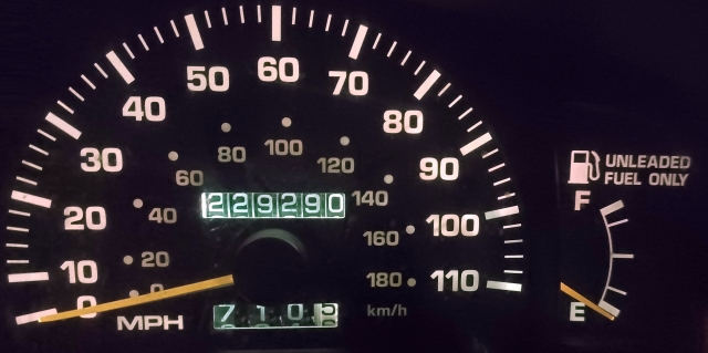

With the car in the garage (on a perfectly flat concrete pad)...
1. From ~1 gallon to bone dry empty it reads just a hare below the last line
2. Five gallons exactly up from bone dry, it reads, surprisingly, at 1/4 tank!
3. Ten gallons exactly up from bone dry, it reads, surprisingly, at 1/2 tank.
4. Fifteen gallons, it read 3/4
5. Twenty gallons (which it took!) it was way over the full line
Yes. It took 20 gallons. For a nominal 18.5 gallon tank.

I also worried that the borrowed borescope would blow up the tank, but in the few minutes that I used it, I was dismayed that I couldn't recognize anything. Do you guys have the same problem when you use an endoscope/borescope in the fuel system lines? Everything was blurry. I didn't' want to tell my friend who lent it to me that it sucked so I just said "works great".
To his credit, the two fuel pumps he lent me did work great, albeit slowly. Don't expect gas-station speeds out of those two pumps.

I could SEE the foot-long 2-inch-wide big fat fuel filler hose and it seemed easy enough to remove the two pipe clamps. Actually I only needed to remove the lower pipe clamp (the one closest to the rump of the tank).
For the next guy with the same problem, if you read this thread years from now, here's a few tidbits I learned the hard way.
1. Forget siphoning. Just forget it. You'll just break a tube in the bends.
2. Try removing only the bottom 10mm hose clamp on the tank rump
3. Best to use a six-inch or longer 10mm hand-held nutdriver
4. If the hose is in the way, remove the topmost 10mm hose clamp
5. Make a note of the DIRECTION (it's not symmetric)
6. Don't even think of siphoning the gas out of the tank from there
7. Use a 12V fuel pump (the one I used from Amazon worked perfectly)
4. I used a 12V clear vinyl carbonation hose, about 1/2-inch OD
5. The hose has to be small enough and yet you do not want it to break
5. It's NOT a smooth run - it's like bumper cars in there
6. You push, stop, twist, push, stop, pull back, push, stop, etc.
7. Blow INTO the hose to feel if you're in the liquid, then pump.
8. It takes HOURS (because the pump is so slow)
9. If you jack the front up as high as you can - you get the last cup
10. You can tell it's empty by the sound of the hose when it hits the bottom
As an experienced person (which I am now) would expect, the proportion of "milk" to "clear" kept increasing as I went to the last 3 gallons, last 2 gallons, last gallon, and down to the last cup (see my milk frothing photos).
Near the end it was 2 inches of "milk" to 1/4-inch of clear gasoline.
I have no idea if there is an anti-siphon valve though, but it might just be the sharp kinks in the pipe that prevent siphoning.
Now I have 13-1/2 gallons of very wet gasoline (5 gallons of which is water).
I'm pretty sure it's not worth letting it settle out and re-using the gas, is it?
But then, now what do I do with my 13-1/2 gallons of milky cleaning fluid?

Yes, you can drop the tank. But pumping is easier. Much easier I'm sure.
One thing I NEVER FOUND was what in the heck was RESTRICTING the siphon hose when I dropped it down from the fuel filler cap?
I see bends. But that's all I see.
Is there a RESTRICTOR or not?
